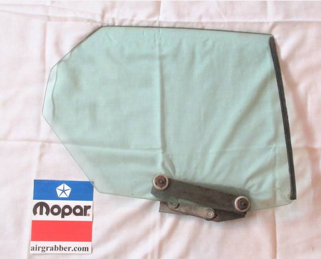

Fixed glass attached with a bracket on to the inner quarter frame. Diff glass than the ones with regulators
73/74 on pic, but the same idea for 71/72…
