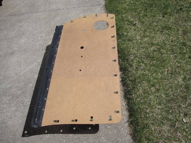

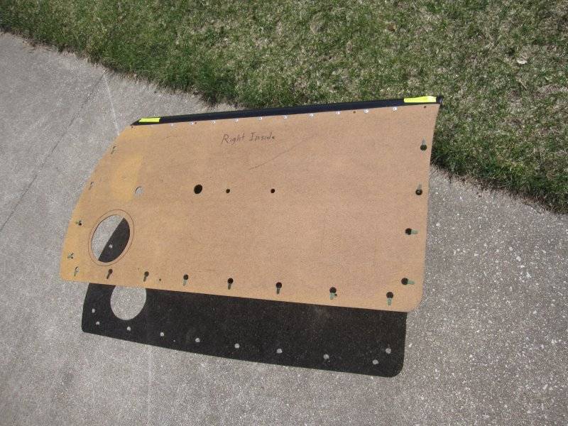

Not totally apples to apples, but I redid these for my 72... Masonite from one of the box stores (I think Home Depot had the right texture on the back to match the OEM pannel). I used a 3M adhesive specifficly for auto vinyl and a box of short, flat head machine screws to reattach the upper metal backing with the door card.
