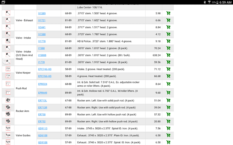

Valves are shot. Ordered a new set from Jegs and after I received notification they were being shipped, I was sent notice that they had been discontinued, soooo NOT shipped.
I just dropped the heads off at a local machine shop to have them milled, new guides, assembled, etc. But, no valves! Was expecting them in at any time and now...
Block needs a touch of clean up in the cylinders and need some File to Fit rings... Annnd I cannot find any!
Anyone have any leads? Need valves and File to Fit piston rings. Everything I am looking for is stock specs.
