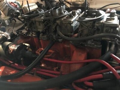

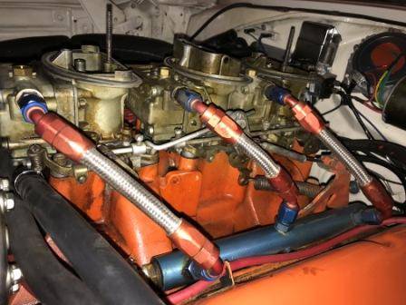

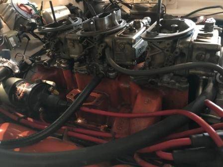

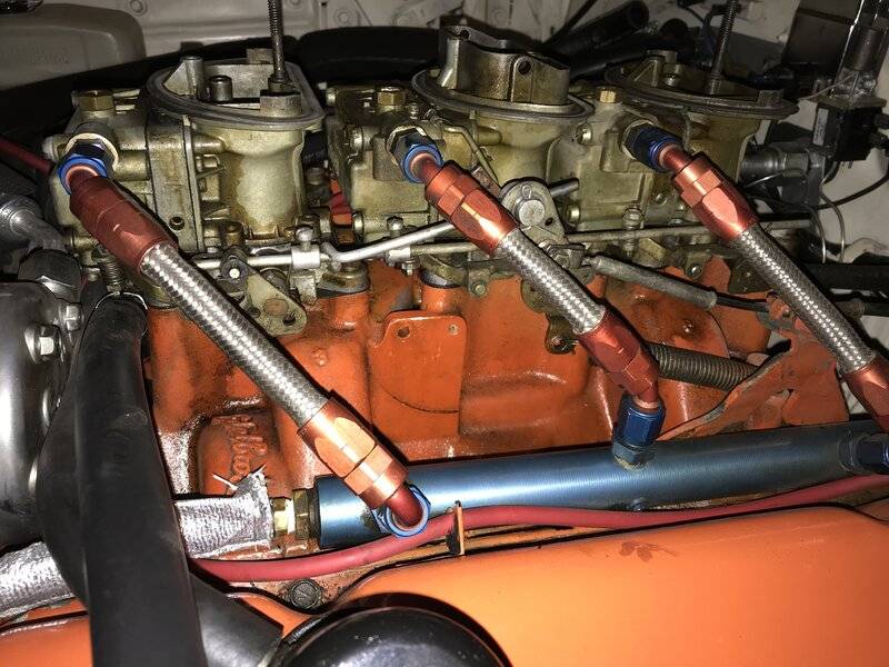

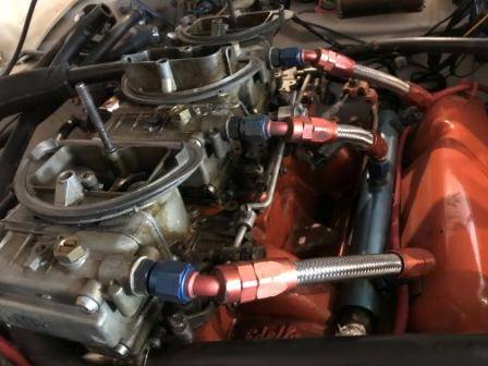

My winter project this year will be rebuilding the 6 pack carbs. I've been running this set up for about 10 years now and the guy who owned the car before me had been running it for many years prior to that. So my guess is these carbs haven't been touched for 20-30 years. Its done okay for me for the past 10 years, but in the past 1-2 years it has started to run very rough on the idle circuit.
As you can see in the pics, this is the old Direct Connection Hustle Stuff 6-pack set up. The outer carbs have the accelerator pumps and no idle adjustments. I'm considering switching this over to the factory vacuum operated secondary set up. For you guys who have experience with 6-packs, any recommendations on whether I should stick with this or convert over to the factory set-up. I think I would have better adjustability/tuning with the factory set-up. This is mostly just a street driven car. Your thoughts?

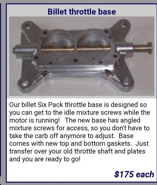

I had all 3 of my Holley 2bbl carbs that were running pretty good modded and rebuilt/gone through by Promax. I have their center carb metering block, which works well and is much more flexible for hotter than stock cams. Also if you switch over to the vacuum actuated outboard carbs (they work great when you have the right springs in the pods) you will want to have the angled idle mixture screws on the rear carb throttle blade plate that Promax makes, and if the front screws have lead plugs remove the lead so they can be tuned.

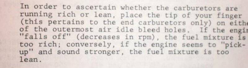

THIS information changed what having a factory 6bbl means from a tuning hassle to an epiphany:
Zoomed in on the critical data:
This is the rear plate w/angled idle mixture screws:

Good advice. If I go the factory vacuum route, I'll definitely get that Promax base plate for the rear carb. I think I might have better luck on the street tuning the factory set up. I just need to decide if I want to keep my current set up or change it over to factory vacuum actuated (I think buying all the parts will be a bit expensive).

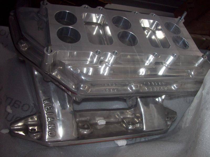

But that cost can be offset by a guy who is interested in your old parts since he has a Weiand P3690982 6bbl Super Stock intake and is building a 541 stroker...

Picture that on the polished finish of that intake, that looks like this:
and I can get ALL of that done by F&B...

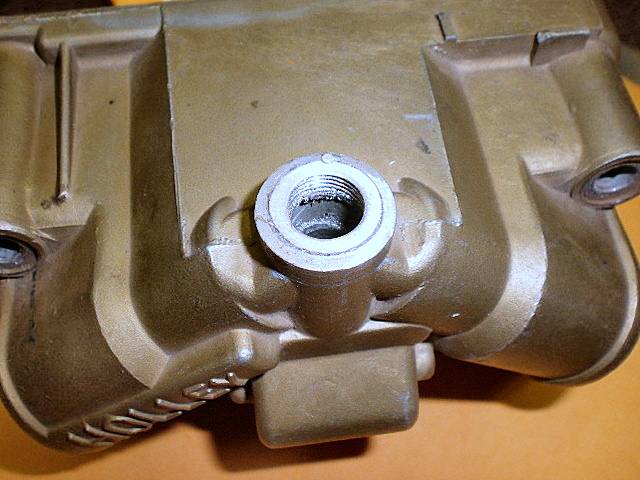

There is nothing wrong with those carbs since they have outer pumps, only reason to switch them would be to get the original look. I will only add this, when you rebuilt them the style of needle and seat you have are notorious for cleaning the threads out of the bowl when you remove them. Hold the needle with a screwdriver, remove the adjusting nut, squirt a little penetrating oil on the bowl and seat threads, let it sit a while to get oil down to the o-ring, work back and forth slowly. You will need 3 new adjusting screws and nuts, as the late style is different.

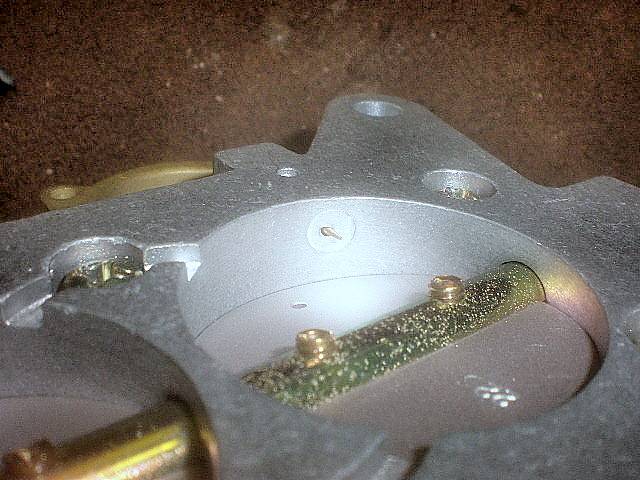

As your comment on needle/seat threads,you would be amazed how many I get with stripped threads.If I get six sets,I guarantee you that at least two bowls will need inserts,same with end base mixture screws with half the head broken off,then they try and drill,end result,also needs an insert. With the cost of these parts if you can even get them,about all you can do is fix what you can.
