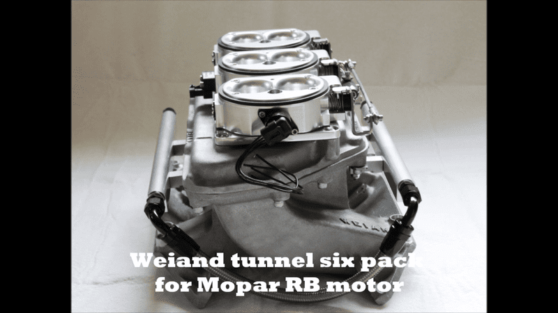

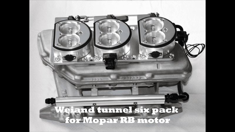

Because of the stroker I have planned, the 600 HP limit of the FiTech unfortunately has ruled that out for me or I'd already have one! FiTech has confirmed there's no way to increase that limit. F&B is the only DPI/EFI option, and it has been done w/the Weiand P3690982 6bbl intake.
I have posted the patent application Holley submitted for a 3x2 Sniper, but I have no information that one exists.
View attachment 1021652 View attachment 1021653
