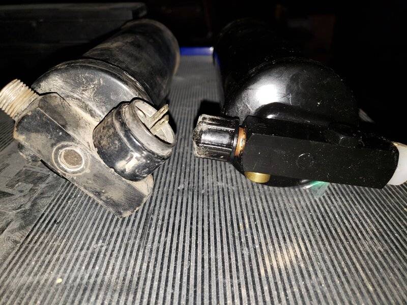

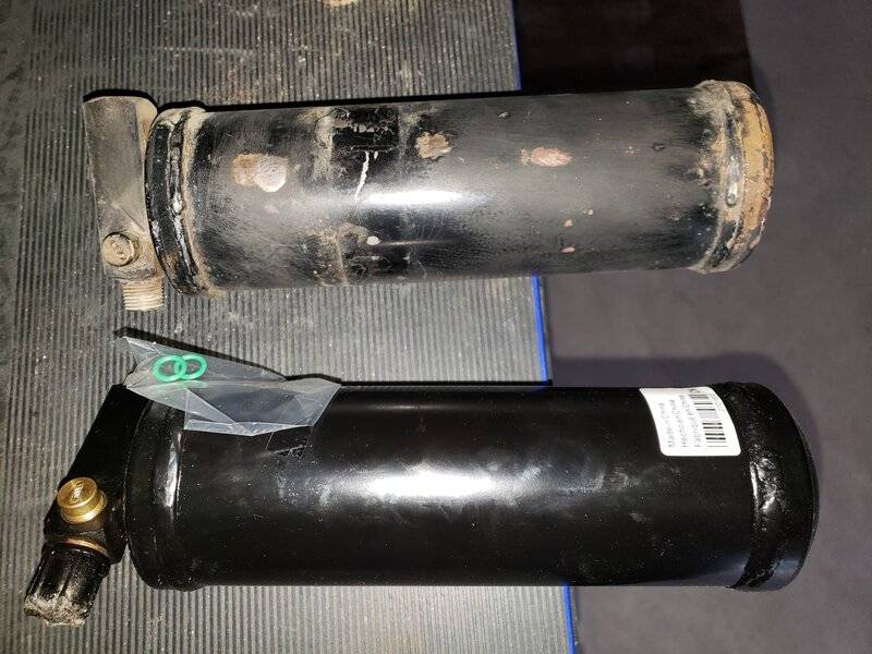

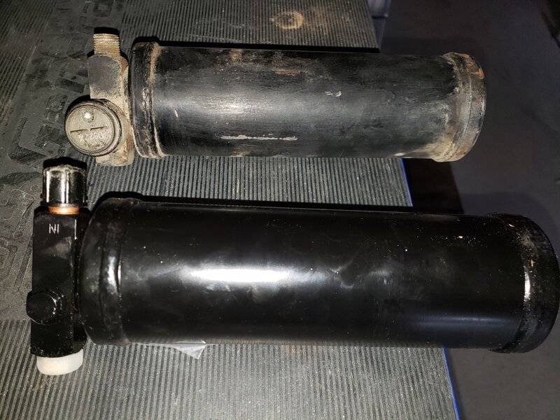

Got a Chinese made Four Seasons receiver/drier for my 72 Charger because the picture in the ad looked like my original. Well a picture is worth a thousand curse words because it doesn't match. No provision for the harness plug in and no sight glass. Are there rx/driers out there that are correct? If not, is it possible to cut the original open, replace the dessicant, and weld it back up?

I’m going to reactive the gel with a few
Hours in the oven at 200F on the 66 since it is the sideways one. Original air can do what you are saying but they are so backed up they are not taking new work right now.
reactivate the gel? this can be acieved by putting in the oven?
The danger is really if there was ever a failure and having metal in it
Well..this sounds like it's worth trying. We'll have to swap notes

You can buy cheap borescopes look up to your phone and look inside And see how things look. Was probably written by an air conditioning company that wants to sell your dryer to remember
yeah...that'd be preferable to cutting one open. though i may on a junk one first, just to satisfy my curiosity
that'll probably be the way i proceed then. any snags to watch out for that you're aware of?

1st the sight can be bought at an a/c place and fitted i to the line after the dryer.
2nd you can get a pressure switch and install it at the compressor. I don't know what your cut out pressure should be but you know that. If converted from r12 to 134a they're both different on cut out.

Is it 134a freon and your manual should tell you what it was. Again if you have 134a it's different than r12.
currently it is empty but had R12. i completely disassembled the car and am putting it back together
Perfect go to your a/c store tell them you need a sight glass inline and a pressure switch inline or at the compressor. Show them what you have now and they will hook you up. Or might have a replacement dryer you want.
