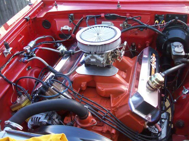

No Osyman, everything is not grounded at one point. The 5 channel Kenwood amp is grounded to the trunk pan (where it is mounted). The Battery has a ground running to the inner fender (under the battery tray bracket), as well to the engine block. Also there is another ground running from the firewall to the engine block. The head unit is grounded to the drivers side dash mount bolt. The power wire, and remote wire for the amp run under the drivers side rocker wire covers. The pre amp outs to the amp and speaker wire back up to the kick panel speakers and center dash speakers from the amp all run under the passenger side rocker wire covers. Be sure you don't run your power wires along side your pre amp & speaker wires, you will probably be hearing a whine. The system is a 5 Channel Kenwood Excelon Amp, Kenwood head unit, Kenwood Excelon 12 Sub (in sealed box, in the trunk), two Polk Audio 6 x 9's in the back tray, Two Kenwood Execlon's in the kick panels, and two Polk Audio 3.5" speakers mounted in the center dash speaker area. Amp runs two kick panel speakers, 6 x 9's in the tray and the sub. Head unit runs the center dash speakers on the front channel. Hope it helps.

Oh I leave plenty of decibel's for that Dave. I built and tuned the system for a nice crisp, clear, full sound.....not the blow your ear drum's out, thumpity thump, wang tang war sounds like some cat's do. A guy can only take so many years of the AM playing "Democracy Now" and "Today's Farm Report" on the crackly 4 Watt center. As far as the motor, doesn't take a whole lot of RPM for that to decorate the halls of the cabin with the sound of brute force. I don't think any system could replace the anticipated sound of a growly big block clearing it's throat.
