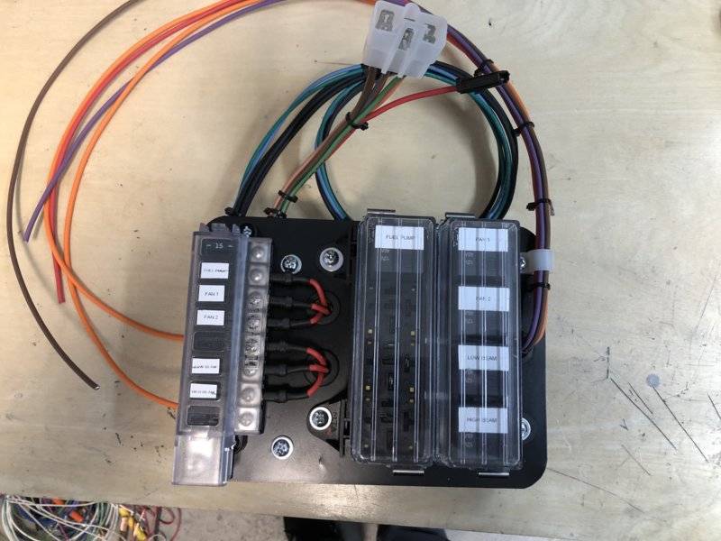

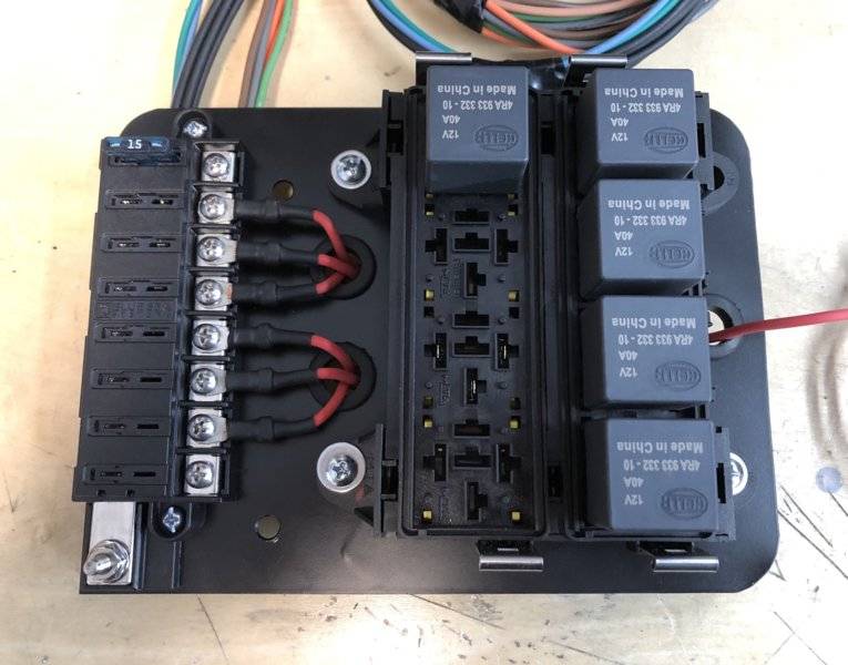

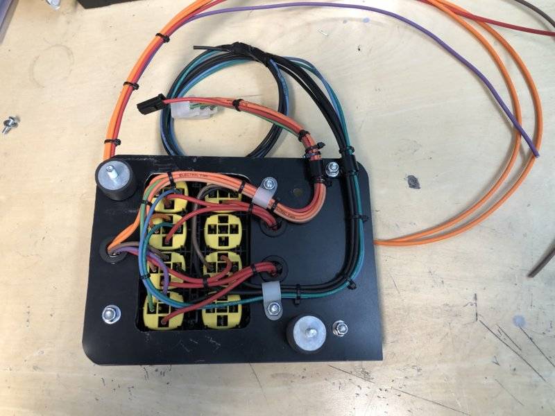

Here is the relay panel that I made. It’s mounted to the firewall under my dash. It has its own feed that runs through a 100 amp breaker.

Very nice I bet that going to work well.
Really like the set up and the quality is top notch. Now will you use a master relay in front of all that to turn it on or direct wire to panel.
