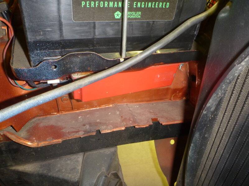

Relocating my ecu on my 78 dodge magnum. Yes it had the lean burn ignition system originally..but the previous owner converted it to a orange box ecu . And I don't like that it's mounted on the passenger side inner fender sorta near the big block distributor and the exhaust manifold. My question is, how close can something be from the ecu without causing problems? I heard that it's not wise to touch the ecu as it is a shock hazzard. I myself have never accidentally touched one. And could it arc to a nearby metal surface ? Thanks in advance, Tony Tee.
