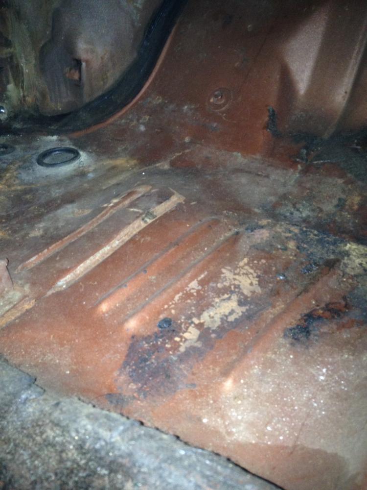

Question for you body and panel experts. How do you remove these dents in the floor? I have tried a big hammer and dolly but its too tough. I have thought of a couple of ways using jacks to push it back, but nothing easy. I'm sure this is a common problem, so if you have successfully rectified this issue, please share.

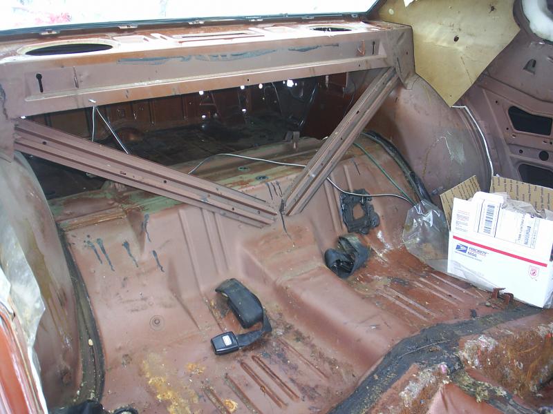

Here is a pic of mine after we took everything apart Jason. Where are your dents?

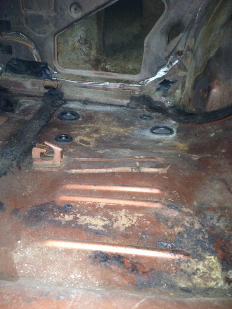

I really only have one major dent and that's as pictured.
Heat is probably the answer, and a repaint is not a problem since I'm due to start restoring her shortly. I was just wondering if there was a fool proof cold method. Hopefully these pics help.

Is the frame rail pushed up too? Sure looks like it's the area right above it....
Definitely not a jacking point.

Hey Cranky, no its beside the frame rail. I'm guessing that it may have slipped off the jack at some stage causing the dent. There is another less severe one under the passengers seat as well, so that's two to knock out
