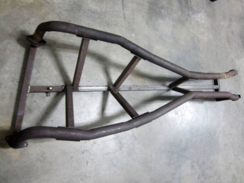

I let Walden's lad Steve do it... before he duplicated my originals! :D
