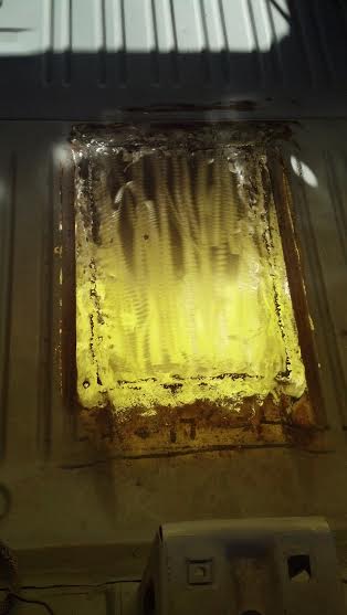

Hey everyone well I was looking for cheap trunk pan to repair my raced out Superbee. It had a fuel cell installed when I bought it. This was a 10 sec race car. I decided I wanted to make it into a stupid fast street car so I removed the fuel cell which left a big hole in my trunk floor. I did find a trunk pan for sale but when I tried to order they said it was on back order. After sitting for hours looking at the pan I decided I could make my own. The sheet metal was about $10.00 and the Bondo with fiberglass was about $11.00. I do plan on adding a finishing coat of standard bondo but the pics don't show that yet. If you didn't know the pan should have ribs you wouldn't even know it was incorrect. I think it looks pretty good. DIY and save $$$$. Oh by the way, the welds were all butt welds and done with the 110 volt harbor Freight wire feed welder.
DSC02324.jpgtrunk.jpgView attachment 229231
Thanks guys. And the best part, got to drink beers.

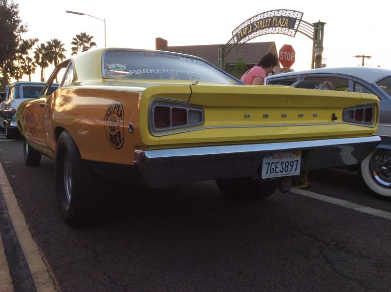

Yep. Solid pan. No reason to replace the whole thing anyway.
Good patch job.
...Oh by the way, the welds were all butt welds and done with the 110 volt harbor Freight wire feed welder.
Nice Job!
