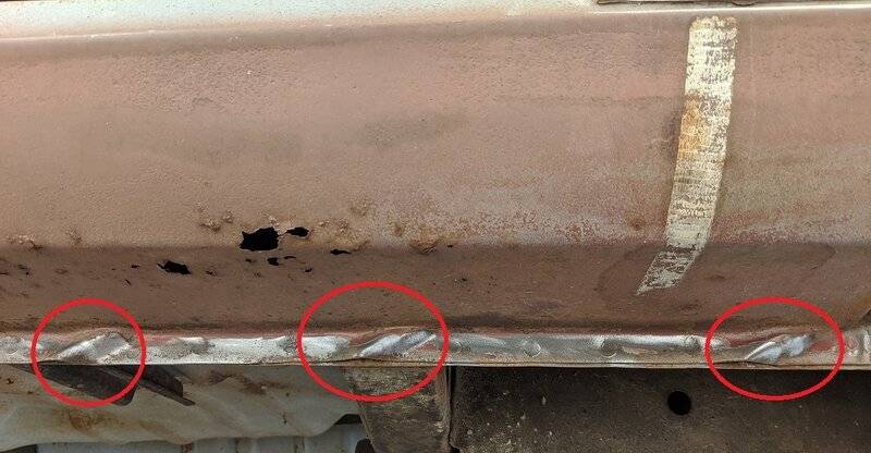

Hard to believe this rocker panel was installed with buckled metal from the factory.
Drains...
YES SIR!!!!
Those are to allow water to drain out, some of the better replacement panels have them stamped in, cheaper panels do not, and you have to make them.
Take a bunch of photos before you remove the rocker. It will help you with the install. Remember, the rockers are a important part of the uni-body, so spot welds are closer together here then on other panels, you want to do it correctly, and def add the drains if your replacement panel, is with out them.
May also want to use some rust preventative on inside, before you weld it up.
