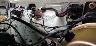

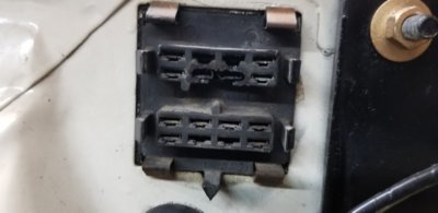

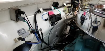

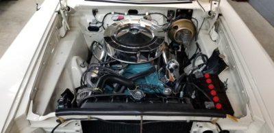

I am installing a new repro from AMS...removing ALL terminals and inserting them into the new block. My 55 year old original has been "burn't" at bottom for a long time. Every once and a while the engine will not turn over because of this...I've had enough of "wiggling" the engine harness connector. Everything is factory stock..no electrical upgrades. The LAST untouched part.

I recently drilled out mine and ran some 12 gauge wire through all 14 connections. I soldered/spliced all those wires under the dash to that harness. Then I added 14 insulated electrical terminals in engine bay. That cost me nothing and I think it actually works better than the original design.

There should be enough slack if you just cut the wire off right at the base of the blocks, right behind the connectors/terminals.

I was planning to replace the bulkhead at first but then ended up deciding I would try the free fix first, Since I had the supplies to bypass it completely
I have a new block. Since I am keeping it completely original I will be replacing at minimum the engine harness terminals. I saw those on Ebay as well. Thanks for posting.
Once you disengage the clips on the block and move it into the hole, you might be able to pull it back through the hole, holding it corner to corner. Then you can work on it in the engine compartment instead of under the dash.

Well I was able to transfer all but two of the 14 leads into the new bulkhead connector. These are the female connectors inside car. Had to order two female connectors to finish due to them being "disfigured".
