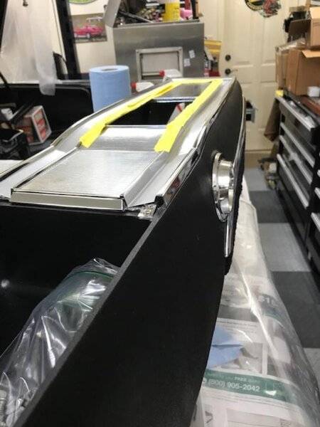

OK - so decided to go ahead and dive in on trying to straighten the top out. Turned out it wasn't that difficult with a hydraulic press and going in small steps. here's basically what I set up.
Basically started out with this set up to flatten the forward section and get some of the upward swoop out of it. Then I found it worked better to use the 2x4 on edge across the plate with a steel plate between it and the ram. And as necessary I used a couple of paint stick on either side between the plate and the HDPE plate as folcrums to help massage the humped section and add some more curve to it. I went in small pushes and slid the plate a little forward and back to not concentrate too much in one area. Many breaks to re-fit on the base and mark where it needed to be pushed next. Ended up looking pretty good overall I think - at least it sits flat and hooks at the front and screws down fine at the rear.
There is still a little gap on the right side in the hump up area although it's hard to see unless you get right down on it. I may see if I can massage a little of it out tomorrow - or maybe just call it good.
Thanks to those who replied about the use of a hydraulic press. I was a bit skeptical at first but worked out just fine. Just went slow and moved the pressure points around to keep from overstressing any one area - don't see any signs of stress to the chrome. thumbnail.jpg
I'll add that a couple pieces of 2x10 or 2x12 oak plank squares laid together would make a good base to use under the console piece. I just happened to have that big chunk of HDPE that I got off of a construction project years ago.
