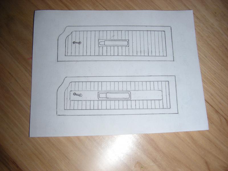

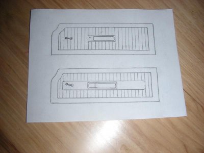

O.K. I need a vote. I was sitting in my car trying to visualize the door panels with the wood trim and can't decide on which route to go. The first plan was a trim strip right where the armrest goes but it doesn't come even close to matching the wood on the dash so I'm scratching that one. The next option is to do it like the 70 Charger, it is still in the armrest area but stops shy of the front and rear and isn't a rectangular shape so I don't think it would look mitch matched. The last option is to put no wood on the panels and instead make my own doors pulls out of the Maple. I'll be cutting the panels and he'll be stitching them up probably with the same pleating as the seats so I can do pretty much whatever I want. What do ya think.

show some drawings or similar example pics 747. I can't imagine what you are talking about
Here you go Tallhair, sorry no coloring but you should get the idea. One is with the proposed wood panel (curly maple)down the center and the other without. The one without the wood panel I thought about making the armrest out of wood instead or just have him stitch up the armrest in leather with the double French seams and orange stitching. I plan on having him stitch them up to match the seat with the same pleating and all.DSCN8837.jpg

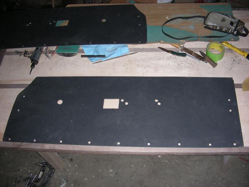

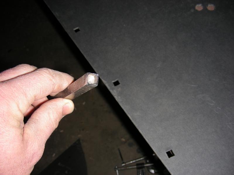

Here's my small amount of progress for the day, both panels cut out and fitted "ready for upholstery". I ended up having to make a square punch for the retainer holes, keystock drilled out and then filed sharp "worked great". Also here is a pic of a 1970 Charger door panel, they offered the center in wood which is kinda what I was thinking but now I'm leaning towards no wood panel.DSCN8836.jpgDSCN8834.jpgthCAO29MKE.jpg
Cool idea, i think that curly maple would really be sharp but if you aren't happy, it wont do!
