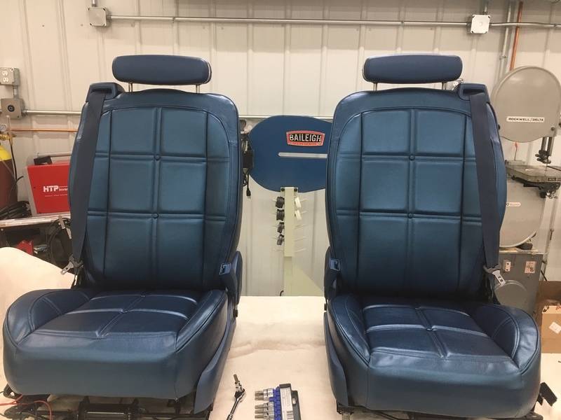

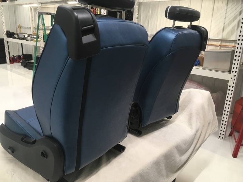

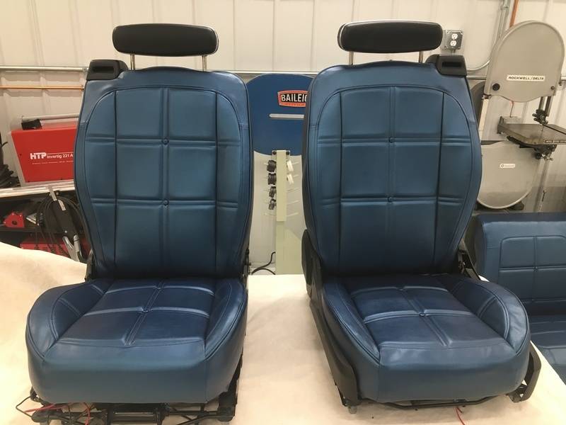

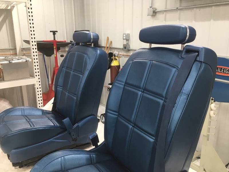

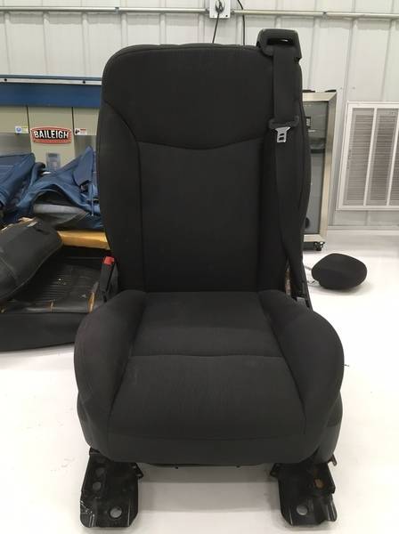

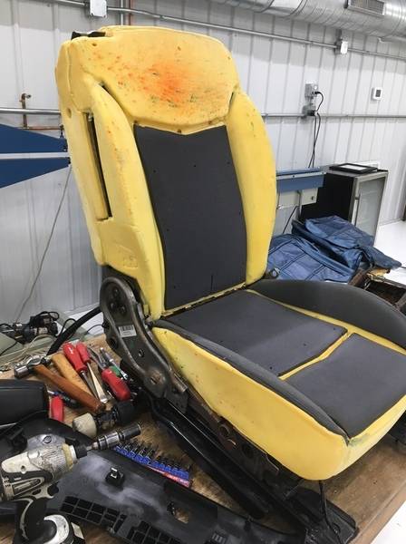

I bought some front seats from a 2013 Chrysler 200 convertible. Somewhat similar to your seats but integrated 3 point belts. Also have flip forward feature and power up/down/front/back.
I'm going to-
-strip out anything unneeded. (airbag and wiring, original brackets on sliders)
-make new mounting brackets
-anchor the rearmost part of the sliders through the subframe connector as I don't trust only the floor to hold the seat in place with the built in seat belts.
-remove chrysler 200 head rests and install 69 charger head rests
-reupholster in dark blue 69 Charger color/pattern and dye plastic parts blue.
-replace seat belts with blue belts

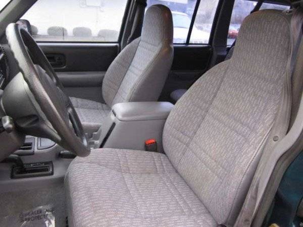

So am I the only one that has been looking at Jeep Cherokee XJ seats???

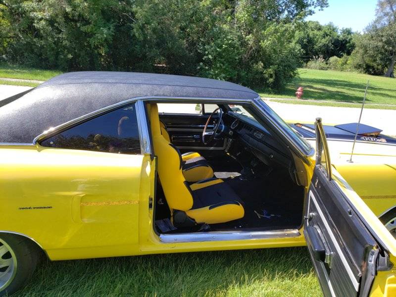

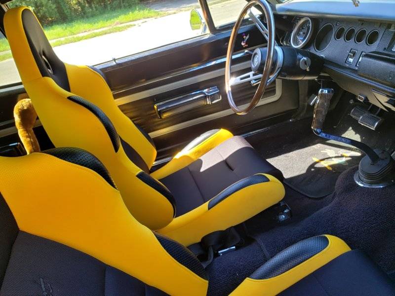

I got a pair of Scat Procar bucket seats for around $300 a PAIR on sale. After driving around for the week of Cruisin the Coast, I'm sold, especially for the price, and they look great in my Roadrunner too!

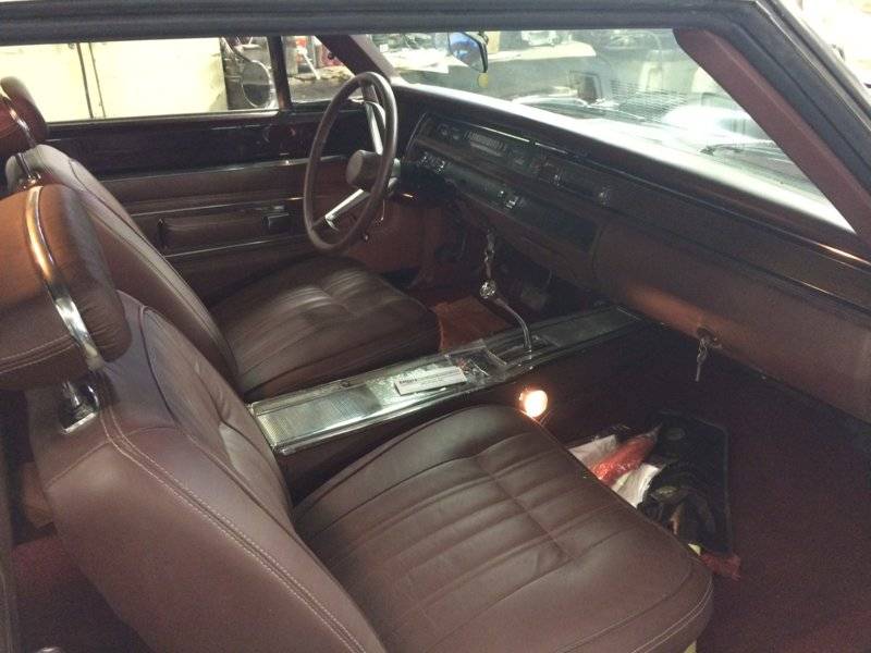

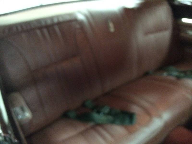

I didn’t go the pro-touring or modern route. But I did make some changes. I wish I had saved the pic I modeled mine off of. There was a 70 RR in one of the Fast n Furious movies that had a sweet new yet fairly period interior style. I took all my interior - which was nearly perfect - and brought it to an upholstererer here in SoCal and had him replicate that style in my 68 X. I had it all done in leather - I picked out the hide, color and the whole nine yards. Turned out quite nice. Very comfortable, looks great and is still close enough to period correct to satisfy me. I love the feel and smell of leather. I’m happy with it. Sorry but the back seat pic is kind of blurry. Only ones I have right now.
Man I love those seats GetXd.
Unfortunately when I got this car there wasn't a rear seat in it and I didn't know how hard they are to find and expensive.
Something will turn up I guess.

I have sebring convertible seats that have integrated seatbelts with power.
