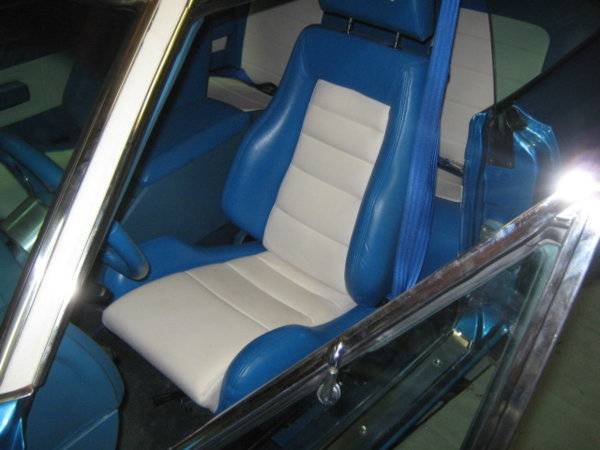

Procar Elite Lumbar seats... use them for street and road racing, and love them. Five point harness fits between the headrest supports
So I’m a big guy, 6’5 290 and I’ve been looking for the right seat. It looks like I’ve narrowed it down to hue procar elite lumbar which has the most width. Nice to see them in a car 65roadracer..they keep you nice and center?
We had to do the universal brackets because they don't make a bracket kit for this car. We placed the seats on blocks first and then tack welded the brackets. They keep me firm in the seats around town, the harness does its job at 110+ in the turns!
I really like the seats, I opted for this one because I race it twice a year, but drive it a few times a month (or more) and they are comfortable. I'm going to have them reupholstered with the rest of my interior soon.
Yours look like an older version...the ones I see know have a vynil covering or you can get them in leather which is pretty pricey.

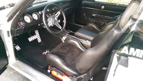

I've got Corbeau seats in two of my cars. GTS 2 in black leather and suede in my charger and Sport seats in black leather in my duster. Both are very comfortable.

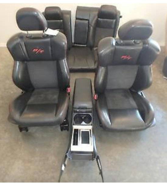

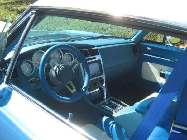

I just picked up these seats for my 68 Charger. They are sweet! Came out of a 2007 Charger R/T.

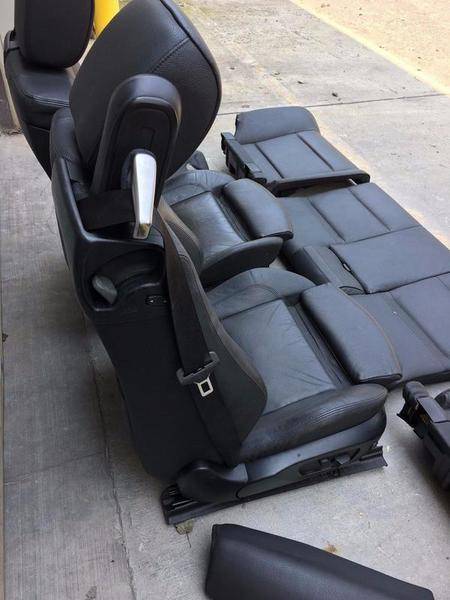

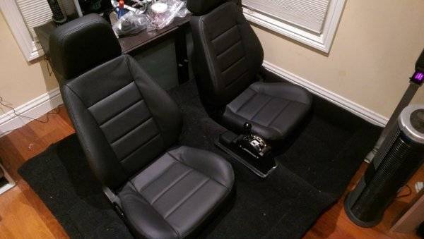

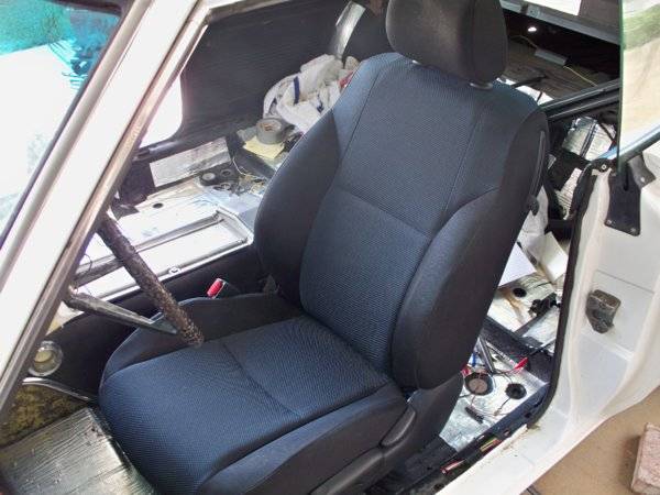

Any guesses? I got these seats - they are manual, fold forward, have a loop for a 3 point belt, and were priced right... $200 shipped from Michigan to CA.

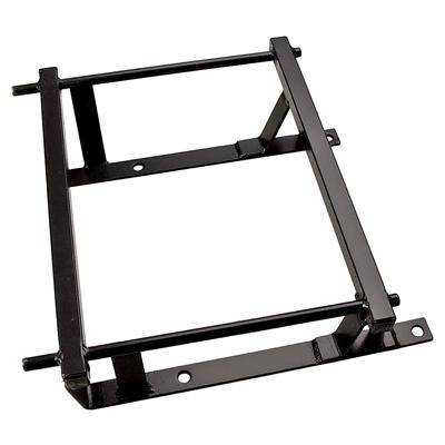

Drivers side base, were like $79 each
Pro Car Seat Adapdter Brackets Driver side SCA-81342 $77.95 Dodge Plymouth.jpg
Pass. Side base
Pro Car Seat Adapdter Brackets Passenger side SCA-81343 $77.95 Dodge Plymouth.jpg

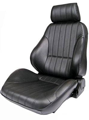

For a comparison
here's the Rally 1000 dimensions & weight {actually 2#'s lighter}
IMO either would be a great choice
Some thing out of a Chevy?
That's what I was thinking. The look a lot like the 08 Mailbu seats I picked up for my 08 Saturn but with drivers power. Changed from the lt grey to the black leather/suede and heated seats to boot. :thumbsup:

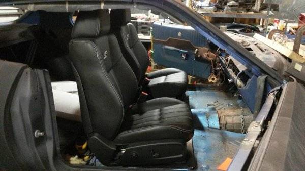

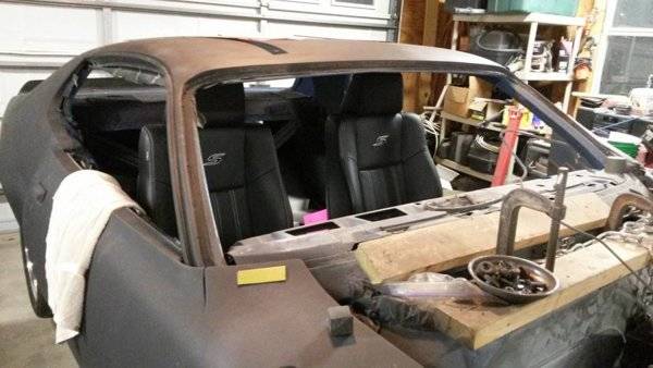

I'm using Chry 300S seats
. Works out pretty good with the "S" for Satellite already monogramed on them...

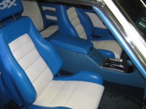

I could not use those seats in my 70 GTX...too tall. The headrest hit the roof BEFORE the liner was in place and that was with the seat sitting on the bare floor pan, no brackets in place. You might want to look closer at that. They were also too wide when using the console from the 07 Charger. I ended up with Corbeau buckets.

I'm using Chry 300S seats[
Looks nice!

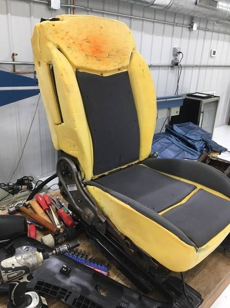

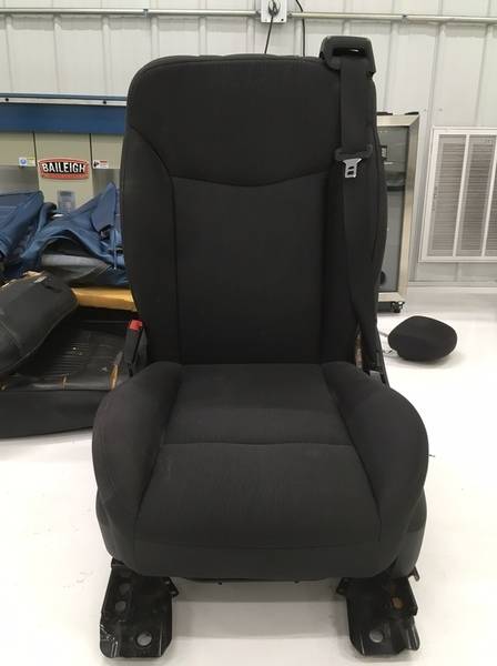

I bought some front seats from a 2013 Chrysler 200 convertible. Somewhat similar to your seats but integrated 3 point belts. Also have flip forward feature and power up/down/front/back.
I'm going to-
-strip out anything unneeded. (airbag and wiring, original brackets on sliders)
-make new mounting brackets
-anchor the rearmost part of the sliders through the subframe connector as I don't trust only the floor to hold the seat in place with the built in seat belts.
-remove chrysler 200 head rests and install 69 charger head rests
-reupholster in dark blue 69 Charger color/pattern and dye plastic parts blue.
-replace seat belts with blue belts
