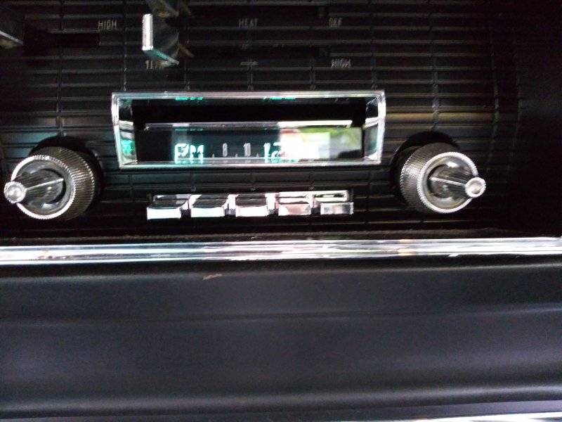

I have the Motor 2 unit, the Technophonic amp and the R-TB8 speakers that I bought through Crutchfield. The problem with the radio is that the display and the buttons are separate pieces and they are a little too close together for the holes in the dash. It can still be installed easily but I can't see the bottom part of the display. It's raining here now so I can't get any pics but I'll add some as soon as it clears up.
Sorry for the lousy photos but the sun and reflections weren't helping. You can see the chrome strip above the display that should be behind the top of the cut out. Since the display and buttons are add on pieces to the radio unit there may be a way to fab another bracket or drill and tap different holes but I was working with the dash in place so I said to heck with it. My car is a daily drive and not a show car so if it works it OK with me. The numbers on the display is an add on static cling decal and it's really hard to read the display with it on there. I'll yank it off if I ever pull it out. They are $30 for 3 of them so I have 2 left over and I'll send them to you if you want them.

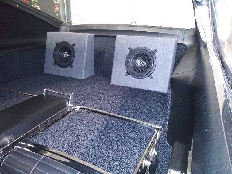

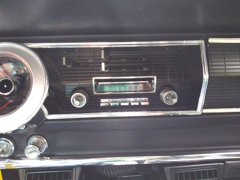

I have the Retrosounds in my 66. The buttons and display are separate and adjustable. It took a little time, but I got it fitting well. One thing I’d was I cut a piece of clear plastic sheet and glued it to the back of the bezel. I didn’t care for the open gap. As for color it’s a very close match. I am not happy with the 4x10 dual voice coil speaker that Retrosounds offers. I’m going to change it to 2 3 1/2 or 4” speakers on an adapter plate this winter. I’m also going to build a pair of sealed boxes to fit next to the rear seats for some 6 1/2” rear speakers and add a sub in the trunk

You can adjust the distance between the display and the buttons with the mounting brackets they supply
The only adjustments mine had were for the knobs, nothing for the buttons or display.

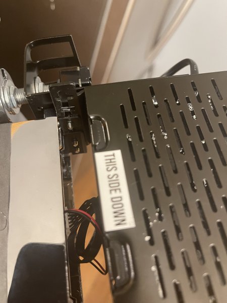

I’ve installed 2. One in my Charger and one in my 67 Coronet R/T and they both had plenty of adjustment. Did you use the extra metal brackets that came in the kit?
Didn't have any brackets like yours and the instructions didn't show any.
