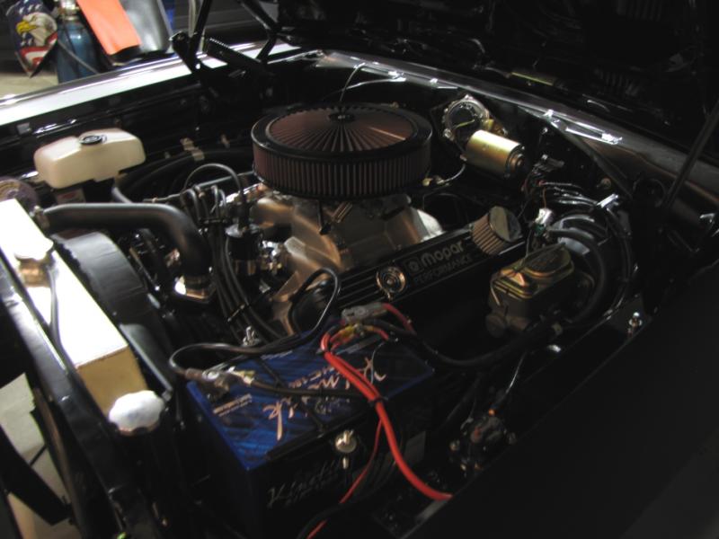

Don't know if it helps, but just another perspective for you. Kinda a dark/crappy pic, but here's the bendix booster mounter under my hood...Vacuum hose is running to a CVR vacuum pump due to the large cam in the stroker:
Its essentially a "Generic" GM booster i believe.

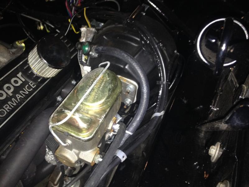

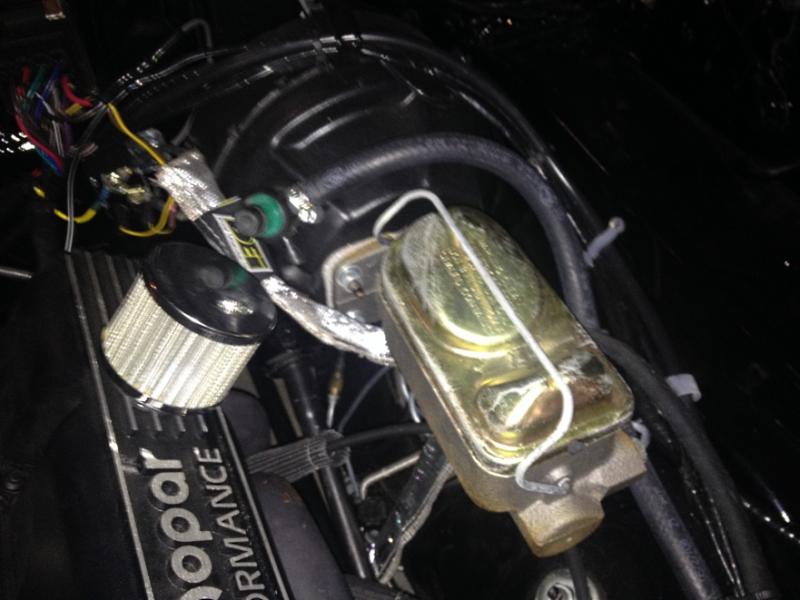

So I called RSD and they confirmed what you said James, thanks by the way. I have to use the bracket. Below are some pics on the install, overall it's not bad for a retrofit disk brake conversion on a car that never had them so I guess it is just shocking to see it in the engine bay. When I first saw the kit for some reason I thought the bracket went on the inside and all you would see was the booster, after researching this it is like what Lew said these are just generic boosters set up for "big blocks" or in reality HEMI'S! why else would you need to raise the booster up other than to clear those massive hemi valve covers?
I also noticed a hole from the original opening partially exposed were the rubber boot goes through the fire wall, talked to RSD about this and they say there is a back plate that can be used to cover it taking the booster back off and installing it then re mounting the booster. I guess I will have to ask the shop to re do some of their work I am sure I will be charged to how ever since he welded the bolts to the bracket on the booster to tighten it up because he thought the whole assembly was flimsy(see pic) I will ask him to at least split the cost since he never called me to tell me he was going to do that, I think that is fair.

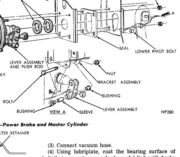

For future reference, does the linkage arm come with the two bushings and a sleeve?
Yes it is, a 64.

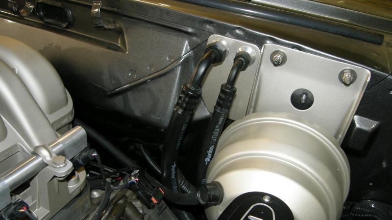

Here's a couple pic's. Sorry, only have a camera phone available so pic's are not that great. Plus it's hard to keep the little lens from fogging up due to the sub zero crap out there. You'll have to let me know what you're looking for in the pic's. I have quite a bit of extra wires running over mine due to the MSD 6AL Harness, single wire alternator 6 gauge wire and some other accessories. Yours would look a bit less cluttered if you ended up going that route.
That RSD booster in the top pic is a Bendix unit commonly found on Fords. My 67 Ranchero has one just like it. From what I have seen GM uses the Delco type of a totally different shape.
