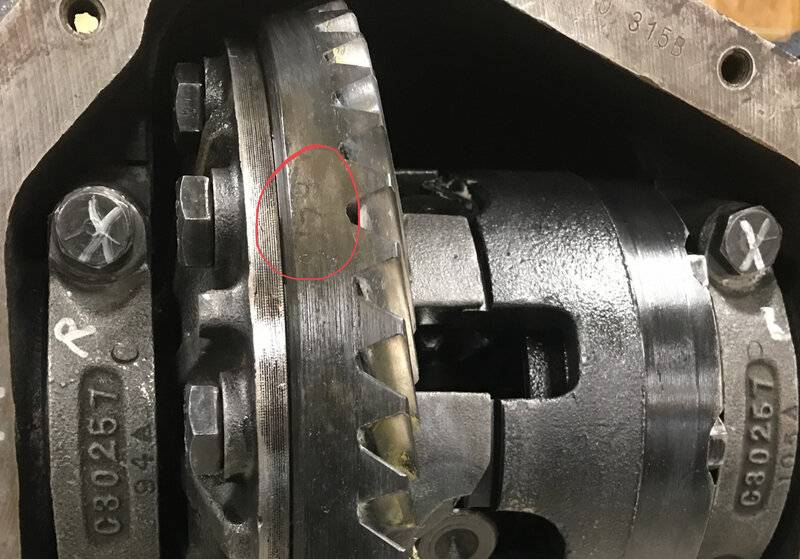

I’ve seen plenty of ring gears and pinion gears with an etched in number that match each other. Look at the head of the pinion gear and the side of the ring gear for what looks like someone used a scribe. I’ve seen this on a lot of factory gears. I’ve also seen where these numbers are not present. It will be hit and miss.

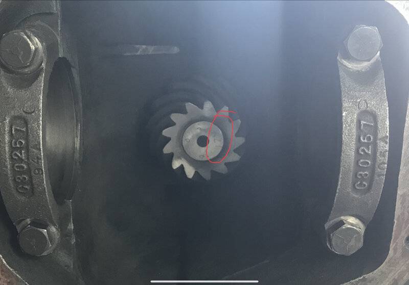

Look close and you will see a 174 on both of mine. Pinion gear below
