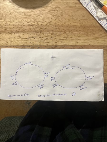

This is how I have done mine for the last 44 years. Has always worked excellent for me. I learned this from an old timer. Kim
I'm about to get the pistons in the block so I've been contemplating ring gap position. I've got two engine building books, the instructions that came with the rings and the factory service manual. They all say something different! The FSM is rather vague, stating, "Be sure that the compression rings are staggered so that neither are in line with oil ring rail gaps. The oil ring expander ends should be positioned towards the outside V of the engine. The oil ring gaps should be positioned opposite each other and above the piston pin holes." I guess that's pretty exact for the oil rings. Use your imagination for the compression!!
Most ring manufacturers use to put insulation instructions in the box. I have always followed the FSM.I'm about to get the pistons in the block so I've been contemplating ring gap position. I've got two engine building books, the instructions that came with the rings and the factory service manual. They all say something different! The FSM is rather vague, stating, "Be sure that the compression rings are staggered so that neither are in line with oil ring rail gaps. The oil ring expander ends should be positioned towards the outside V of the engine. The oil ring gaps should be positioned opposite each other and above the piston pin holes." I guess that's pretty exact for the oil rings. Use your imagination for the compression!!
