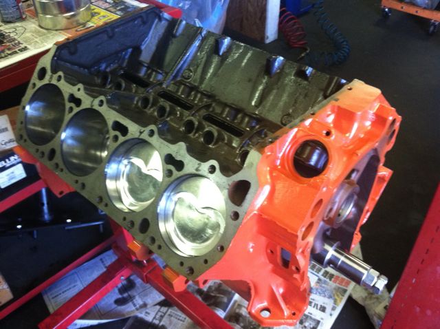

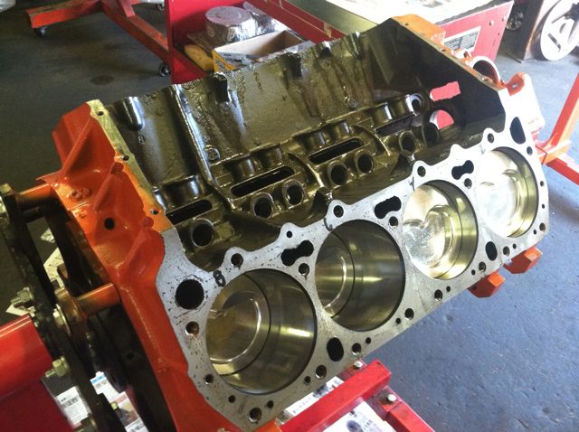

Here's the latest on the Road Racing Engine Build:
Mancini 493 Stroker Kit
Mopar Performance 84cc Heads
Crower custom hydraulic roller cam (see spec sheet below - sorry for the blur)
Crower roller lifters
ARP bolts and studs all over the place
Milodon Road Racing oil pan

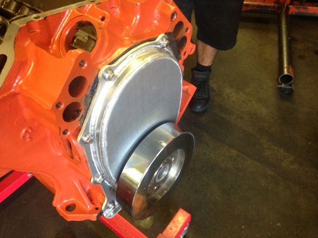

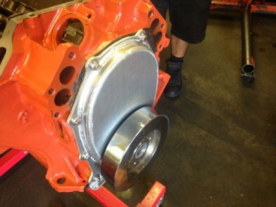

440 source front cover and fluid balancer w 440 source high volume water pump and housing (fits with their front cover)
The build is still underway. The cam is in, timing chain on (cam at 4 degrees advance) and the front cover is on after about half a day of fussing with the cam button and the front cover fit. The cam is pretty mild for an engine this big, but at advice of some here and my engine shop I am being pretty conservative. There is no need to go crazy with an engine this big. We'll have plenty of horsepower to go fast.
Next: Intake manifold and carb. Builder likes the Holley HP, probably 800 size, so I'll likely go with that. The motor is meant for road racing, so it needs to run at all RPM ranges and needs to be able to sit at relatively high constant RPM in order to turn 100+ mph for an hour at the Silver State.

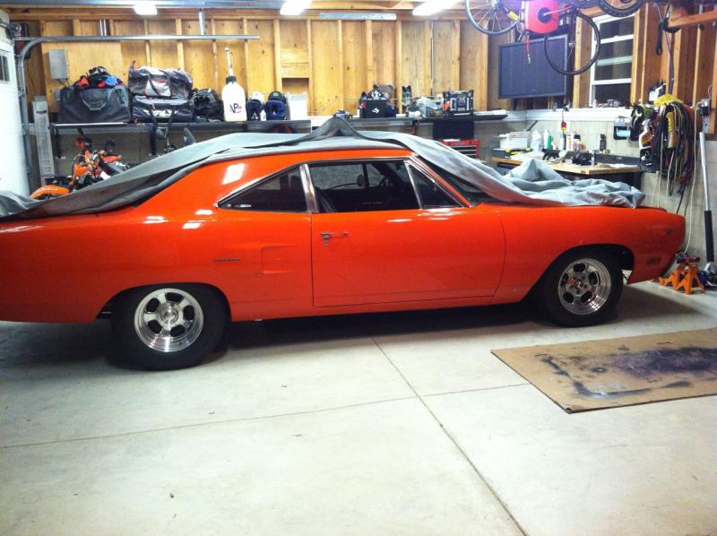

Got a pic of the car in current trim as well, with the new Wilwood front discs...
