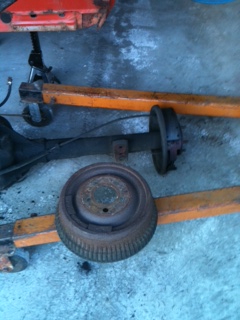

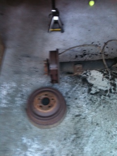

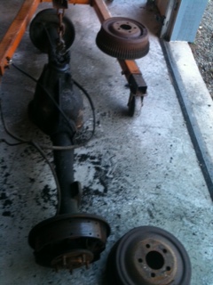

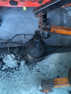

It's a Dana with 3.55:1 gear ratio. Already thinking about upgrading it with some 4.10:1 planetary and pinion gears. I still haven't opened it yet but my guess is it's a sure grip. Hoping it's a clutch type too. The brakes are complete but the brake drums are two different types one the newer finned version on the right passenger side and the flared out ends on the driver side. So happy I found these not too far from where I live.:headbang:

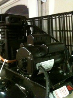

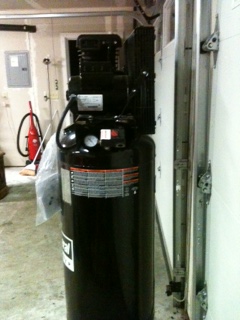

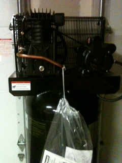

One of the most priceless tools in a garage! Good deal. Looks like all your ducks are lining right up.

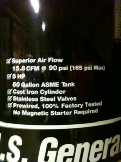

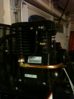

Already planned and getting the rotisserie by the 15th of this month. In the mean time I'll be blasting and drilling out factory tack welds to replace and repair metal panels. So what do you think? Any advice and comments are welcomed. Thanks.
Roadbird, since you posted and asked for comments, that air compressor is good for filling tires, and some small air tools, blasting is an no-go at this station. Even the smallest sandblasting rig requires double the cfm your's has. You're fixxin to waste a lot of time undertaking this this way. I only say this because I did the same thing myself and wasted precious resources and time. Send your stuff out bro, focus on what you can do, if you just have to get your blasting fix, do a fender and start the clock for timekeeping, take before and after pix and post your findings. Good luck!
X2 on the blasting,i tried it with one that size and it dont work very well.Most air tools will work with it.A D/A and inline air file take a ton to run and mine works well with them.
X3....I run one a bit bigger than that (2 Stage). Will run most air tools. Will also run my cabinet blaster and Eastwood 100# Blaster. I spot blast small areas and small parts with it. Wouldn't try blasting a car with it. Would take hours and hours and hours.....Ok, more like days. I'd take Donny's advice on any large amount of blasting. My Cabinet blaster is priceless and I use it all the time. I would recommend you plumb in a real good Air/Water/Oil separator and Regulator. An auto oiler is real slick for air tools. Also, a dryer/desiccant system if you're looking for dry air (like for spray guns). Design in traps and drains if you're plumbing throughout your garage.
