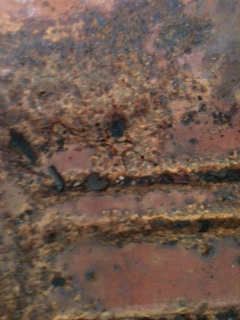

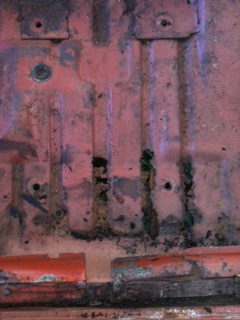

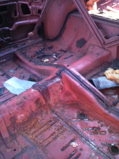

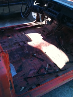

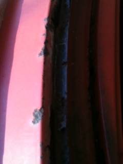

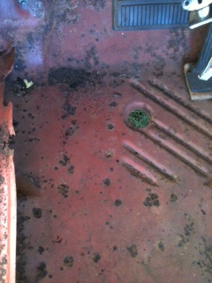

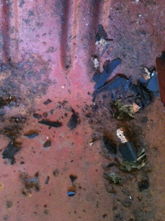

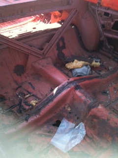

Well folks it's been awhile since I posted anything here on my thread. Basically today I have been scrapping seam sealer off on the interior floor pan in anticipation of completing my move to my new home. And begin working on my 70RR. I plan on replacing partial floor pans and keeping the drive shaft hump. Here are some pics.
Here it is.
Isn't it fun scraping all that off? Are you going to replace the pan in front of the rear seat also? If you are going to replace the floor braces too, make sure you mark them with a grease pen or use masking tape so you can put the new ones back in the same place.

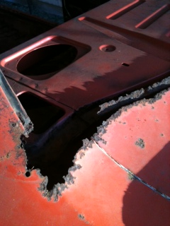

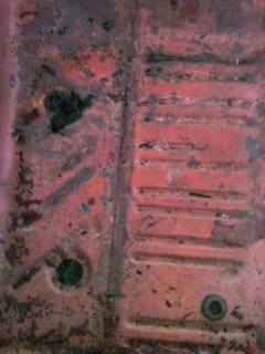

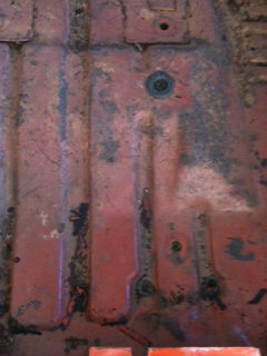

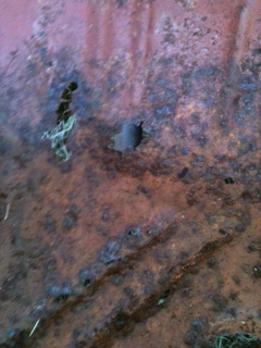

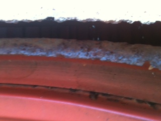

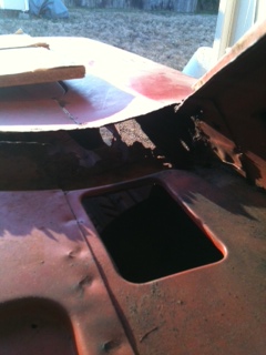

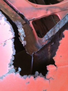

Oh yeah, I had fun doing it, because I didn't have anything to do today and I was dreaming of how the car looked when it was all done and imaginatively driving it all around. It was fun and can't wait to start. I should be moving in to my new home sometime this month (sale pending) sign is up at the new house and just waiting to close the deal. Here are few more pics of what I scraped off today.

I hear ya. It can be time consuming but we all know it has to be done.Hope everything is moving forward for you on the house.
It sure is but not fast enough. I'm revving to move and start this project because I feel like I'm dieing to drive it already. Can't stand it I really just want to smoke some tires right now.

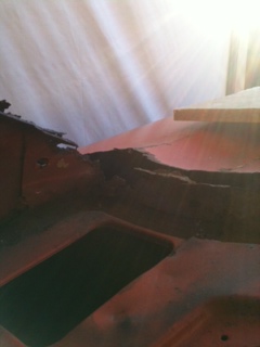

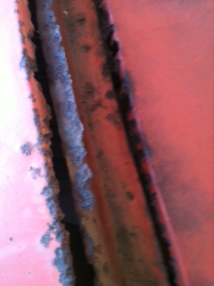

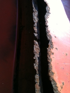

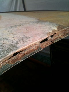

Great progess, those lower rear corners at the back glass does not look so fun but I bet you make them look like new! Keep up the good work!
You bet it's going to be fun. And yes my plan is to replace those corners and everything else thats rusted back there. I also plan on removing the roof skin and cutting out rusted metal and replacing them. Not replacing the whole roof btw. Once I move to my new place and settle in I'm going to heat and scrape off undercoating from the bottom of the car and then media blast the entire car. Alot of work ahead for Roxanne but I look forward to it. Thanks FBBO folks for your replies, information and encouragement.

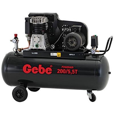

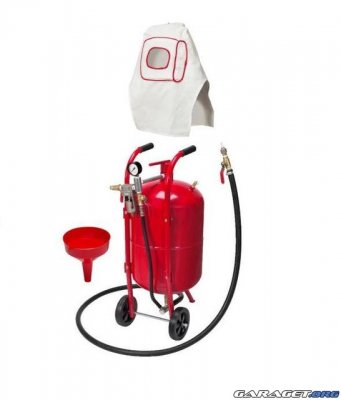

Hi John, been there myself for two years ago and this is how I solved it, first I bought a small compressor (2.0 hp) that I gave away to my neighbour the next week, the other one (4.0 hp) was also to small so I sold it to a friend for tire pumping etc.
Then I bought a used 4.4 kW (5.5 hp), 53 gallons tank that flows 18 cfm and I set it for 140 psi and it works for me. Payed like $ 300 for it. This is a 400 volts machine.
I would aim for a 5.5 kW (7.5 hp) with a 70 gallon tank if I would get a new one, my 4.4 kW has to work pretty hard to keep up with the blaster. But they get really big, over 440 lbs!
Try to stay away from HF and get a quality compressor, a china compressor does not have spare parts and if you change oil and filter and empty the tank from water on a regular basis they will last for long. It is like welding machines, better to by a used proffesional machine instead of a new china crap!
P.S. Remember not to use the small sized hoses like 1/4" and so, get up to 1/2", otherwise you will loose a lot of cfm, and keep the hose short between the compressor and blaster tank, no need to have 100 feet if it is enough with 25!
This is the type I use:

Thanks and that looks pretty good. Okay then, I'll keep this in mind. I'm thinking of spending about maybe $700 - $800 on a maybe double pumper floor model then. Thanks Swede and you too Donny. I think I got it now as much CFM as I can afford but the higher the better, thanks again you all.
