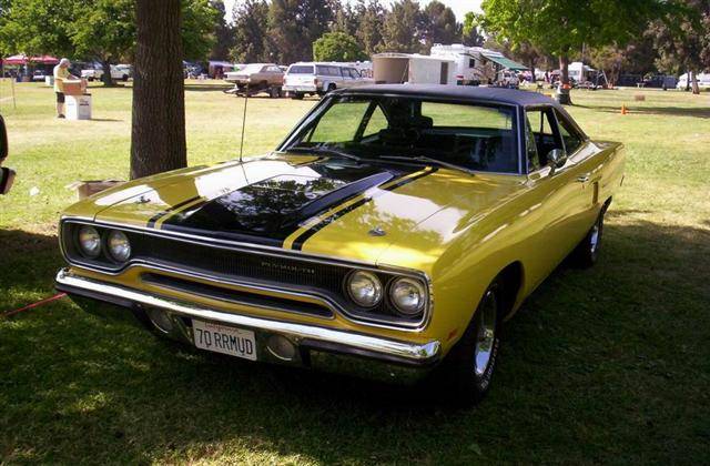

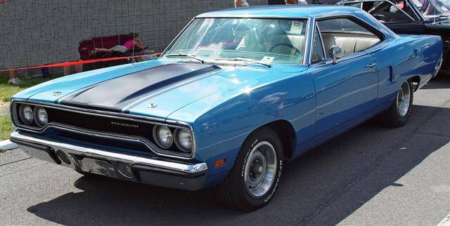

Im not quite sure what kind of pictures you mean, but i had this one and thought id put in for you.. Inspiration maybe..
Forgot about this one, Don't know where i got it but always liked the shade of yellow on it..

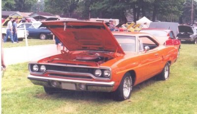

Nice and thank you very much. BTW the Roadrunner dust trail on yours is that a different / extra option code or is it a part of the A87 Roadrunner Decour Package?

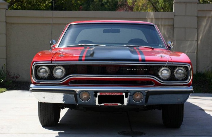

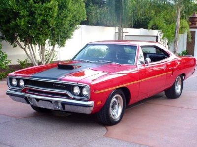

Here's a couple 70's in Red Roadbird...Tried to find the orange, but "Hemi Orange" is a 1969 Dodge color for exterior, 1970 Dodge went to "Go Mango". Being it's a Plymouth, are you referring to Vitamin C orange perhaps or actually looking to find one with the actual Hemi Orange on it?
That's the factory stripe. Wish I still had the car.

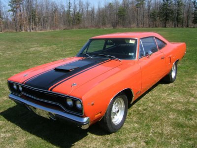

Alright....someone correct me if i'm wrong please, but I think this is a '70 in Hemi Orange:
