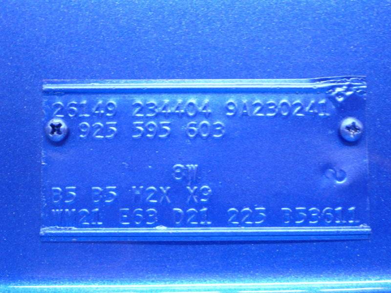

            @dadsbee, if you dont mind, what does the 8W on your tag mean? Just curious, i can't figure it out.
            Edit: I'm sure it's in your build thread, i just didn't see it.

            8W = V8W = white bumblebee stripe
            Carsten
            • Thanks! Thanks! x 2

              Ahha, its a dodge thing! My rr book didn't have it. Thanks fc7!

                it is the same on Plymouth tags from Lynch road for the 1969 model year, too.
                There was just no "V8-" stripe available but "V6-" and "V7-" stripes instead for Plymouths.
                "V6-" is a longitudinal tape stripe and "V7-" a painted pinstripe.
                So ie an RR has a white tape stripe from the factory the tag would read "6W" = "V6W"
                Carsten
