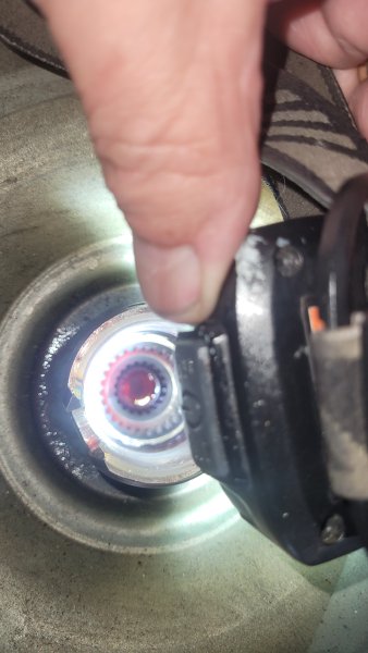

So, I apologize for being a Dumba....s up front. I was wrong on the spline count. I was looking at the outer count not the input shaft. See attached photo of the old Torque Convertor. Zoom in and it looks like 19! I know this can't be. The other photo is before I installed the "New" engine. If you zoom in you'll see where I marked one spline with a white marker to do my count. I think it's 18. I've e-mailed Hughes today but they are closed. As for the filter, Fatsco sent me SKU 12. I don't see that on their online catalog only a SKU 17, which says it's for a 1966 or newer. So, I think I have the right filter. I agree with everyone that I won't know much until I drop the pan.
