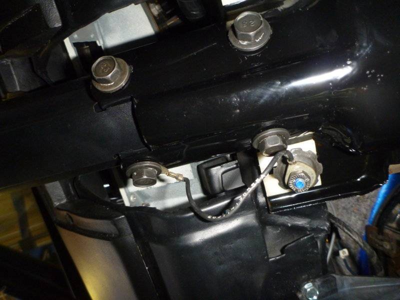

Do you have the ground jumper on your column?

No I do not, what does that do?
Exactly as described... it's your ground wire to make the horn work! The column is mounted on plastic sliders so you need the ground wire from frame to column. The horn contact ring is completing the ground circuit to the horn relay.
