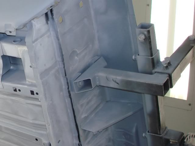

Nearly finished building a rotissirie for my 74 Roadrunner and was wondering where it should attach at the rear of the car. I have considered the frame but not certain where to bolt it. The other option is where the bumper mounts to the rear of the trunk. Suggestions and even pictures would be helpful.
IMG_20150302_242911_492.jpgrear shakle
Bolt it to where the bumper brackets attach to. Just like what 72RoadrunnerGTX shows.

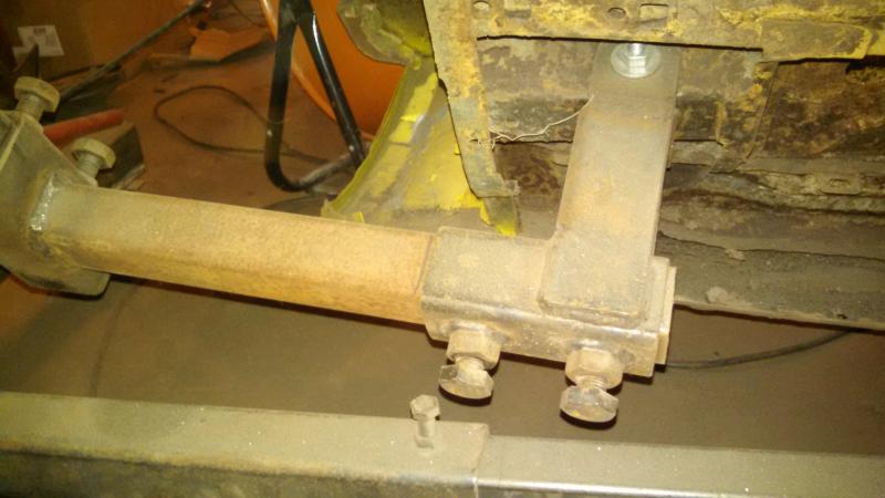

I think either way works, mine was done on the rear leaf spring mount points.
