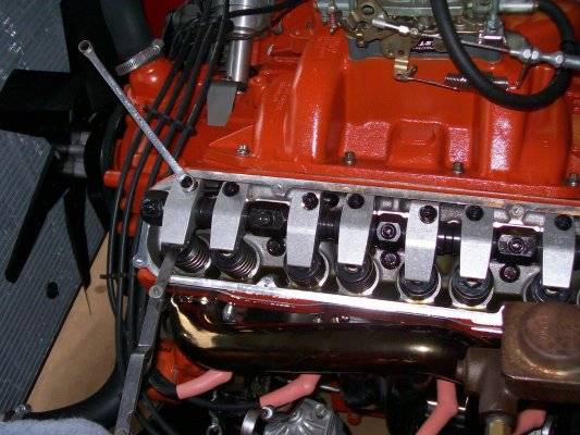

I've had the Hughes 1.5 roller tipped rockers since 2011
505 big block
585/600 flat tappet
928-16 Comp spring
Since 2011
Over 5,000 miles
One full season of bracket racing
Lash hasnt moved

I have been using these Hughes 1.6 roller tip rockers since 2011 and they are still working great. Ron
