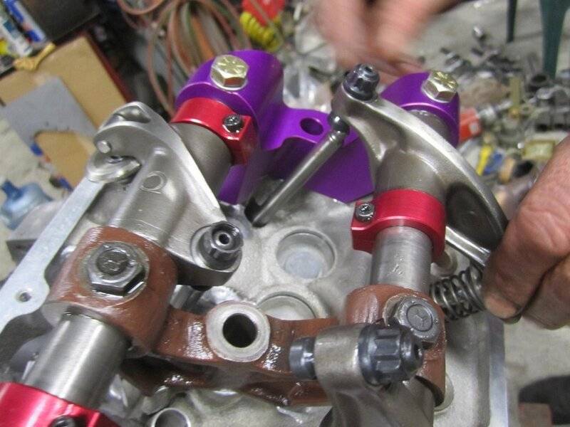

wear data take a look at lifters from a comp 268 and from a mp 260 or engle after say 50 k miles spreading the load out to a larger area helps

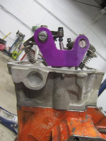

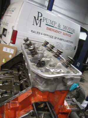

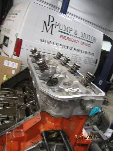

Hemi rockers and geometry is even more fun. When I installed aluminum heads the intake rockers were too close to the valve spring. Had to go with a -.050 retainer,,,,, in return the valve spring pressure went high and had to replace the new springs with a lower spring pressure to keep everything happy. And yes I did clearance the rockers.

I ve had customers who had rocker tips look ok on the seat but come off the tip when reved up with disasterous results, droped valve, rod cuts the cam in half

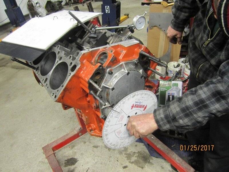

always check at closed and at max lift
rocker arms are all over the place

Thanks very much. I'm leaving it at 1.5 Small hydraulic cam @.488 roller tips are centered when closed and don't seem to deviate too far inward when opened. but I only checked with a breaker bar on the crank bolt turning slowly and stopping at max open. Dunno what it's like when revved up. But I don't think a cam this small will cause it to slip off when revved up. But then again, I'm not that smart. I'm so stupid when it comes to this issue - that I'm best off leaving it alone. It runs fine. I'll just count my blessings and leave it at that. Thanks for your input though. I appreciate it very much.
