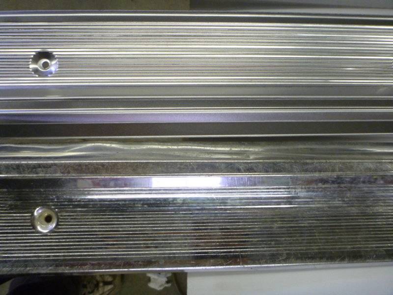

They are aluminum and they should be dullish.. not BRIGHT like a lot of the reproductions.
My Bird's OE's top and a comparison of incorrect repros to almost correct repros bottom. Dull is correct..

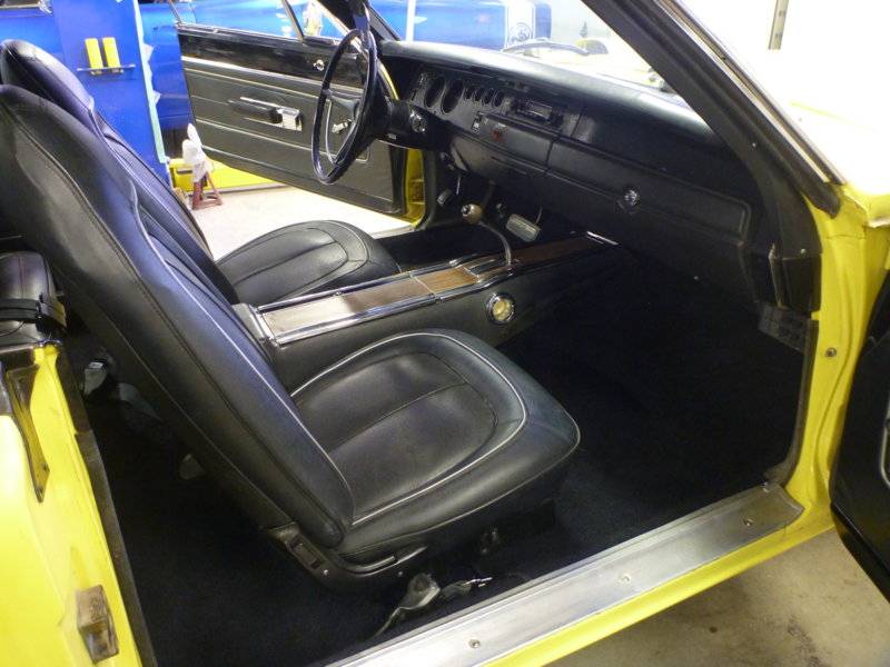

I don't think he's talking about the sill plates?
Are you talking about these, Hilljack?
Was your R/T a 68?
It still is.... The car is still mine.. The rocker moldings were hammered but were definitely original... The original owner took it off the road around 76-77....
...but thanks for identifying the sills as aluminum too, Wayne.
Yep, that's them. Nice unit! :thumbsup: Is that yours?
No sir, just a pic I found online.
