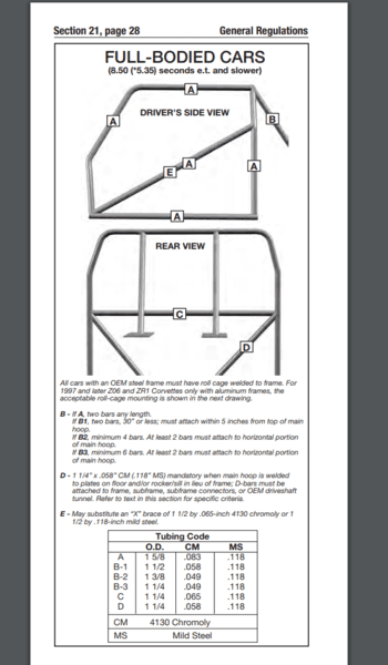

This is off Page 28, 2019 NHRA Rule book for full body cars.

you can get the whole rule book here.
http://promod.nhra.com/userfiles/file/Tech/2019 General Regulations.pdf
Full body cars start on Page 28 for roll cages. Page 29 talks about some other good useful information
Great, just what I needed. But I didn't see anything on the front end frame support. That's the one that goes between the dash bar and front frame rail just in front of the shock tower.

I'll pull it back up, there's a line in the rule book that states dash bars and all cage support bars have to be 1.25 x .118 MS or 1.25 x .083 CM to match the rest of the cage.

You'll notice that the min for MS is .118". However ELW tube wont pass this spec unless its .134". However DOM .120" will pass. It can be Mig welded. The cost is more, nearly the same as CM. The nose bars have no spec as they arent considered necessary by NHRA. I used 1.25".

Thanks to all. I got it all figured out. I read the rules on the link that dukeboy_318 sent referenced.
