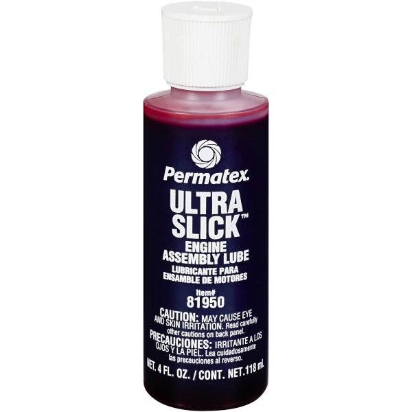

This.
Take a dab of that between your fingers and see how it feels then do the same thing with the other hand with STP and see if there's a difference. Years ago I tried that with some assembly lube but don't remember the name of it. Couldn't feel a difference but the price sure is different....

Good too know.

I remember my dad telling me that’s what he used (STP) in the 70s when he did his engine building.

Use a liquid lubricant, oil or the stuff in post #8....which looks similar to the lube that Comp Cams supplies with new cams.
I used a Crane lube for many years, both SFT and roller. The Comp lube looks and feels the same. Even on a roller, it doesn't hurt.
