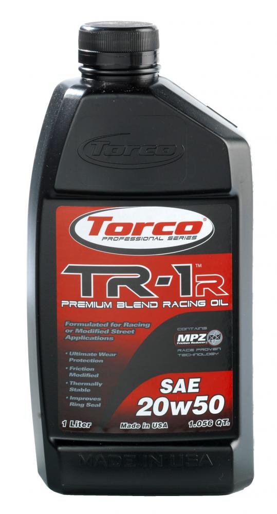

I ran Torco Racing oil for 30 years
Various different viscosities, some with a synthetic base in all my race cars,
I never had any failure because of any issue with oil break down, loss of lubrication value
I had to change it more often when running Methanol, turned to mustard looking baby diaper chit
plenty of Phosphorus Zinc Oxide {or now ZDDP} additive blended into most of them too...
I agree for the most part, there's allot of mumbo jumbo agenda's
out there when it comes to oils & Zinc content, depends on who you ask,
ask 10 people seems you'll get 10 stories/likes or dislikes
I have {had} a buddy Doug that works for Chevron/Standard oil
My Grandad Whitey worked for Shell Oil as an Engineer for 40+ years
My Uncle Ron worked for Chevron/Standard Oil as an VP Engineer for 40+ years
My buddy Doug in the Richmond Ca. CRC {Chevron Research Center},
he did destructive tests on different oils all the time, many different brands &
different types of tests, fuel/chemical breakdowns or dilution, longevity, wear & cleanliness
he was also a devout Div. 7 drag racer, he also affirmed/confirmed my thoughts about
Torco Racing Oils
