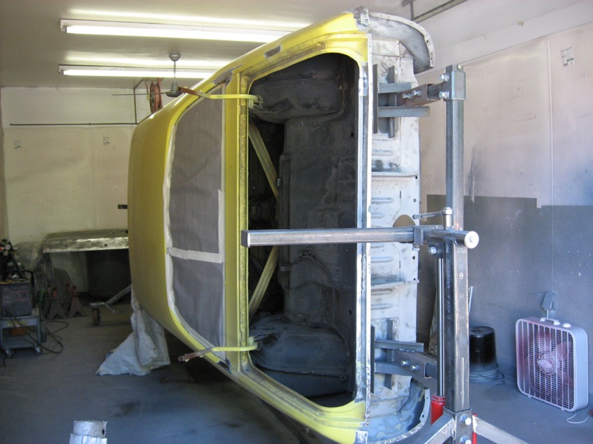

Here's my purchased one. I'm six feet tall so that might give you some perspective.
I'll try to get some basic measurements for you in a few days.

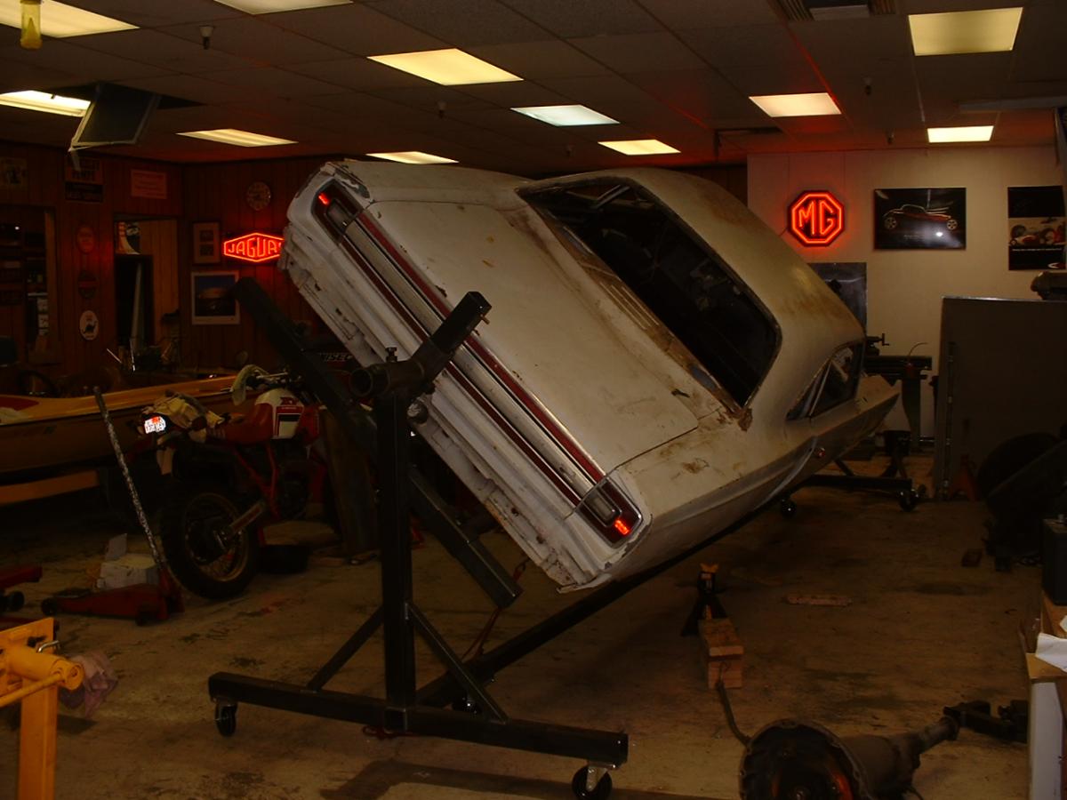

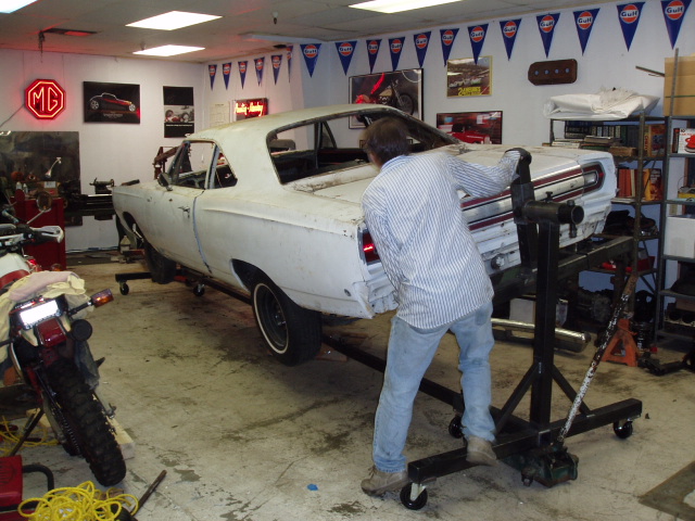

We had ours built by a local guy. Could have been built a little stronger, but it works.

I was in adjustment mode in this pic, plus the suspension was still in it. Now that it's stripped to the bare body I can flip it over no problem.

In the front of the car, the bolts go to where the bumper would bolt to the car, and in the rear, bolts go through where the rear bumper would bolt to the car. We had to weld up our own brackets to bolt to the car.
I'll see if I have some more close up picture's.

I have been thinking to do one also. Sence steel is quite pricy ja time is money so my plan is simply buy two heavy duty engine stands (example allstar perf. #ALL10176 $88.99 pcs.) and modifyed them a bit. Have to chance upright tube longer and brace it, maeby a telescope inner tube if you want it higher, them built the bodyhangers where normally engine would be bolted. Then make a connection tube between stands and you are done.
My calculation is that its cheper to by the stands and modify tham than start built from scratch. Cos this way dont need to machinied anything, just tube inside a tube, cut , drill a couple of bolt holes and weld. Machining with lathe takes lot of time to do right, find the materials. Wheels comes with it so dont need to buy them.

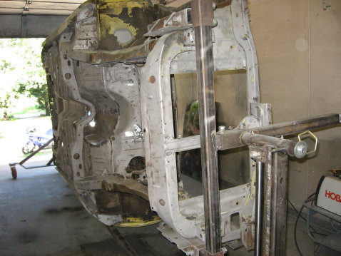

My rotisserie is based on a design similiar to the one sited by generaljmwlee with these execeptions: the horizontal members at the bottom that the wheels attach to are 3 inches, the attachment points to the car are 3/8 plate with drilled holes, 3/4 bolts are used through out. You can rotate the car with one hand without any fear of it going all the way over and you can push it on gravel by yourself with 6 inch soild tires. When not in use it breaks down into a small pile that can be easily hauled in a pickup. It also works on brand X vehicles such as a boss mustang with the addition of 2 holes. I have built three of this design and find it simple and very functional. Wayne

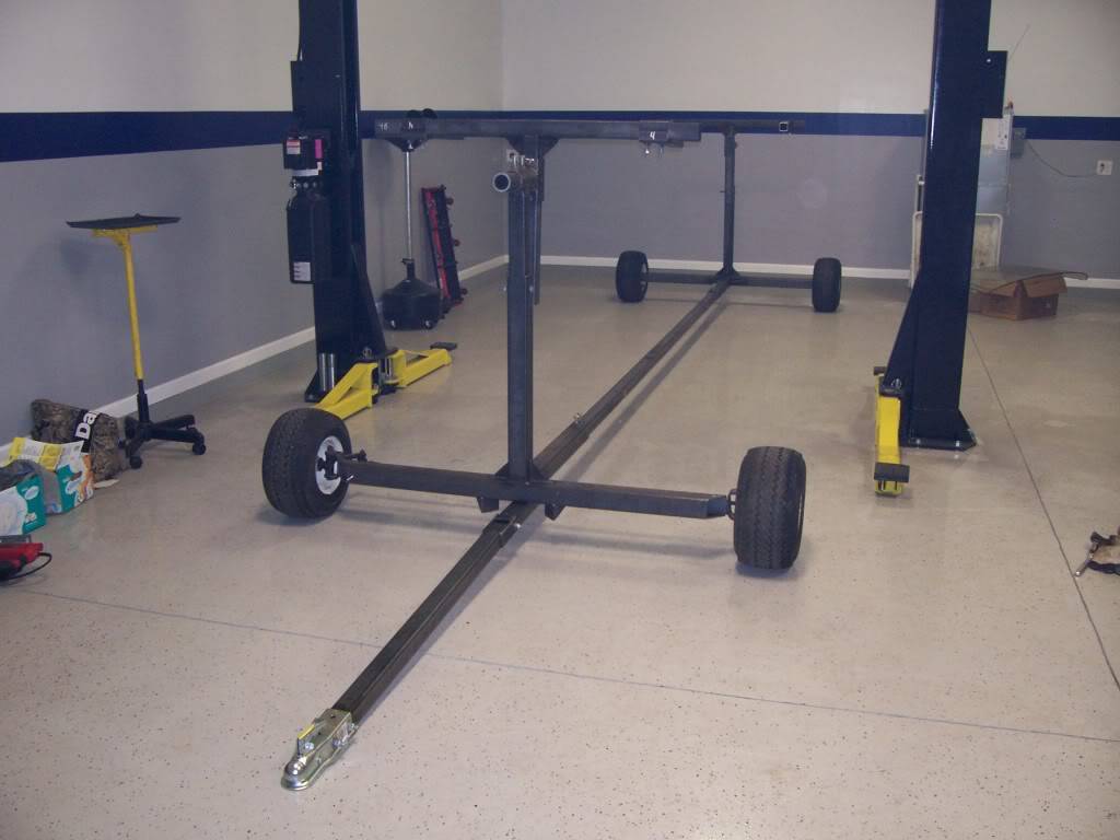

The bill for my steel was $340 (not cut) add about $200 to that if you want everything cut and ready to build. You should not need to machine anything b/c 2.5" tube 1/4" wall fits inside 3" tube with 3/16" wall for the greased pivots.

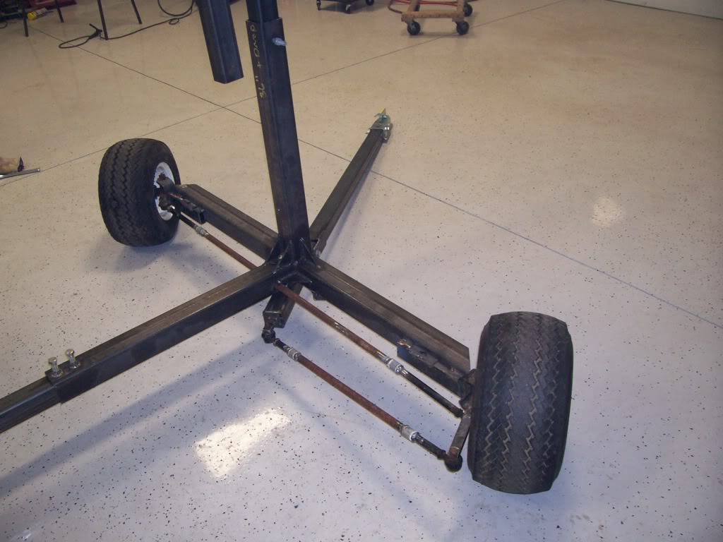

I cut up an old golf cart (FREEBIE) for the wheels/tires/axles. This will get the rig from shop to blasting area outside. I'll post pics, but the idea is the front wheels will always turn/point parallel to a tow bar hitched to my ATV. The rear wheels area fixed axle, like a hay wagon setup.
There will be caster mounting plates too... for "improved surfaces"

These are the plans I'm working from:
The basic size is from Harwood's plans, but I changed a few things after looking at some other designs. It will come apart for storage or transport and has height adjustment.

Pics with fabrication done:
