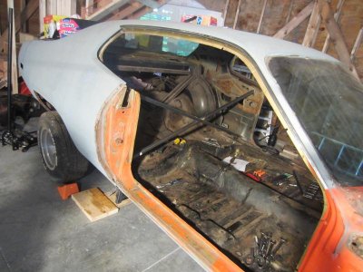

I'm not a structural engineer but, this is what I did before putting my '71 on the rotisserie:
Nice. OK I will focus on the floor first and do some bracing. Can't hurt right?

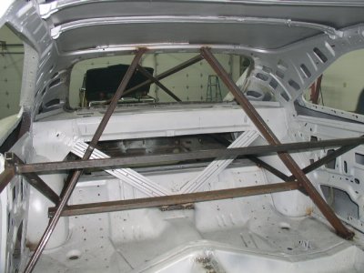

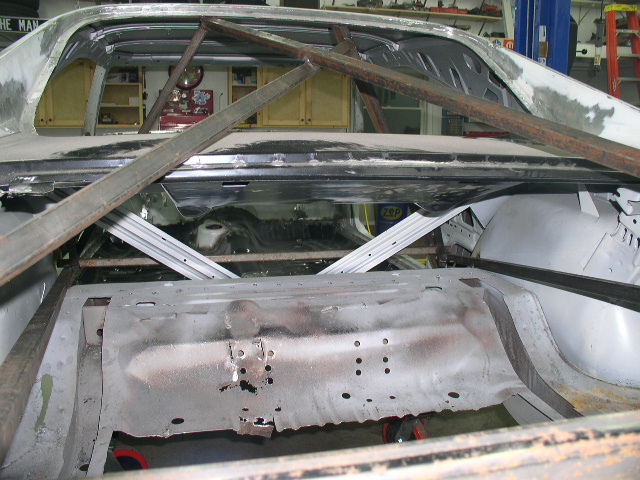

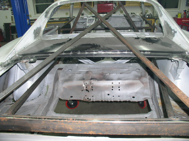

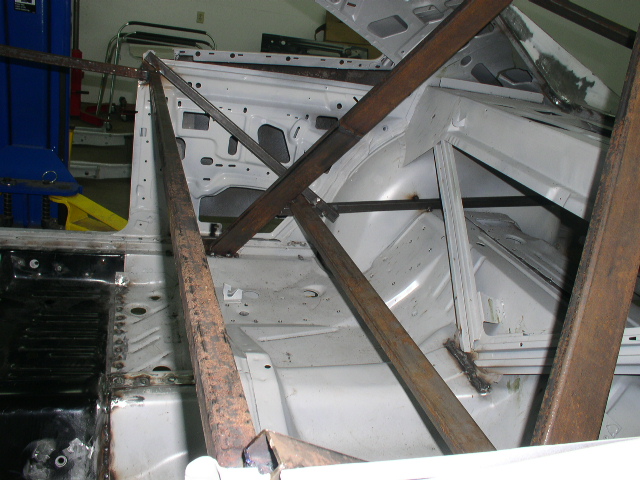

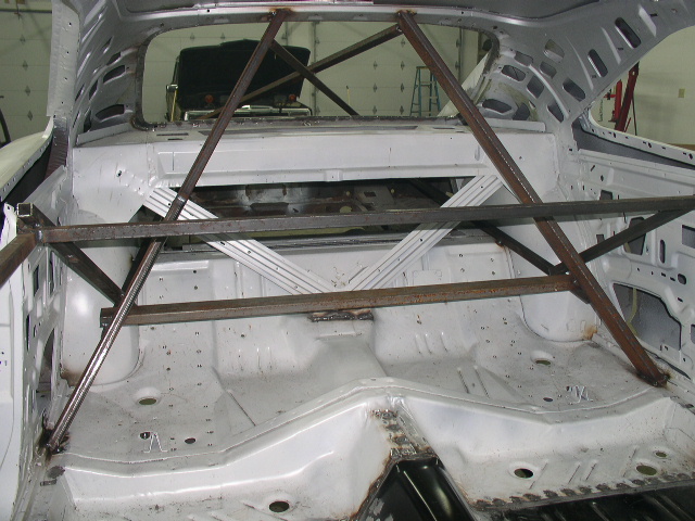

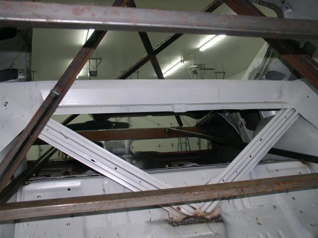

Better safe than sorry I figure. Here are some pics. from when we braced up my Charger.
Wow that's a lot of bracing. Better to be safe than sorry. Looks good.

Totally agree with you Matt. We replaced so much metal on this car including the rear frame rails. Why take a chance with something moving or flexing?
