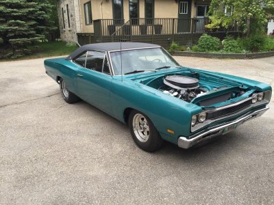

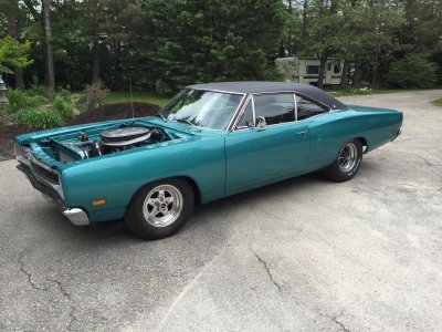

Further describe the jarring. Road surface? Speed, turns, braking. Post a picture showing stance and tires.

As you can see, it's not excessively low, and I have big tires (15" rims) on it that should take up some of the impact on the road. The sound seems to be coming from the front end rather than the rear.
I'll grease the front swaybar and monkey around with the front end a bit to see if I can fix it.
Beautiful car. Love the stance. Keep us posted.
