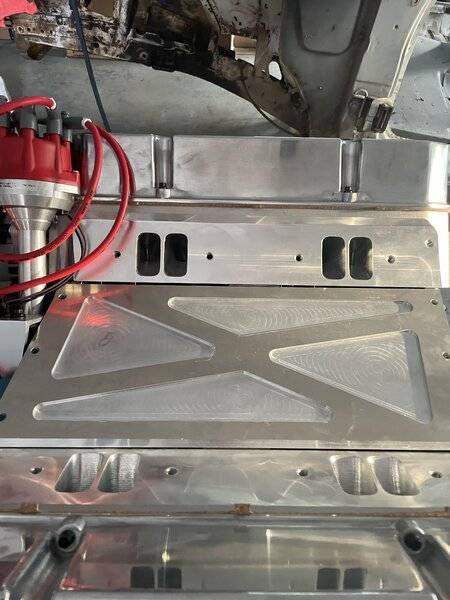

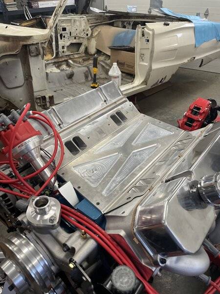

03F8556D-57C2-415F-86CF-4B6EEBD8C228.jpeg 10A2AFF2-5A09-4EA6-BCA6-7F9EC4FC10EF.jpeg
Pretty fancy for hardly being able to see it! Lol looks like something I would do. Anyways, nice job looks good and yes you can mill that off if you need to.

thanks all. Ya. I had the 440 source pan but didn’t work with the gasket holders (pan too thin). I made this pan and the gasket holders. I think I’ll mill down the intake as suggested. (If anyone wants the Cad drawings LMK)
