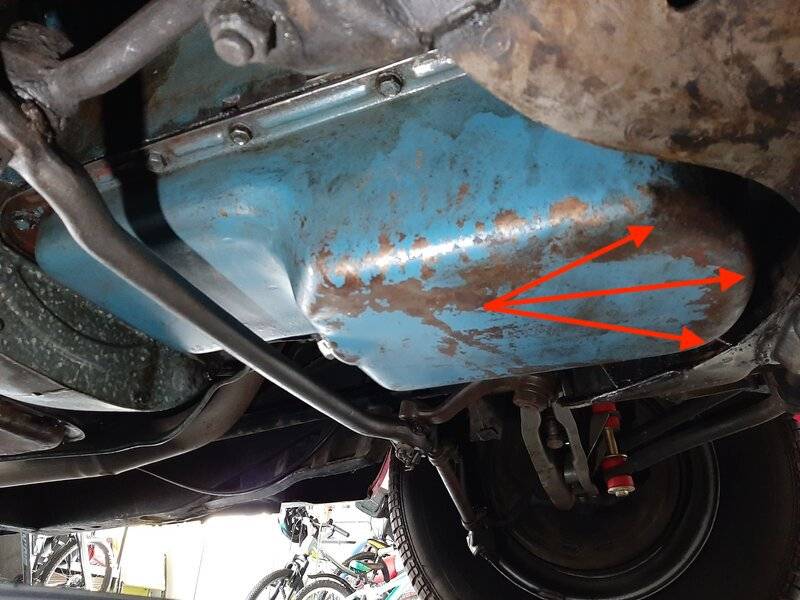

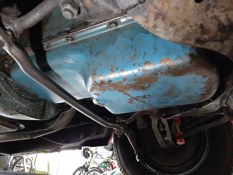

Think my oilpan is original, but can't find any stamping (402 or so) on it.
Thank you!

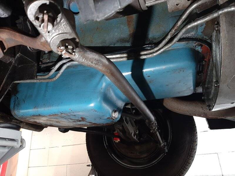

When the pan is curved and follows the shape of the K member you have the big pan....
72 U-codes use an 854 pan which is 6 quart.

Here are 2 photos.
