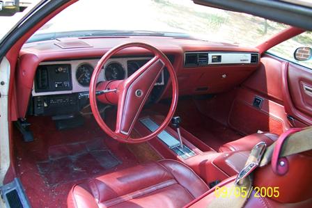

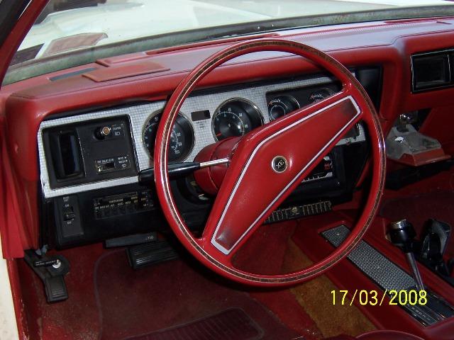

1979;
The GT and 300 have a machine turned dash applied to them instead of the wood grain. (See below) The machined turn treatment was applied to the passengerside dash panel, upper dash where the gauges are and the bottom half is blacked out instead of wood grain. If equiped with a center console, the wood grain foward the shifter is swapped out for machine turned decoration.
