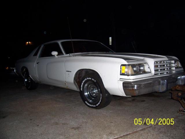

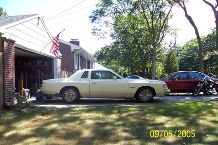

I introduce to you, my 1979 Magnum;
A Cordoba by any other name lol
I always liked the styling of the Magnums. I liked the "Cord" inspired grills in them. Never driven one, but made a mad dash across town once cause someone told me about a Magnum GT they saw for sale.
was gone when I got there
A little rusty, alittle crusty, all mine, this project car turned everyday driver was picked up off the 1 and only owner whom purchased it new for himself.
After many years of service and well documented record keeping, even light bulb replacements, he told me he handed it over to his daughter for collage for 4 years. And then his son for 4 more years. Both atteneded schools upstate New York.
I live on the Island and it will take you an hour to get off this damn sand bar without crazy traffic. His kids did come home on the weekends since they were only a 2 - 2-1/2 hours away. And of course, kids being kids, they drive everywhere and record nothing but memories and good times...........and a few tickets.
He then used the car for approx. a 10 year run as a daily comuter from his house to NYC where he is a fireman. I know the miles, it's 50 one way to work for him, 100 daily, 500 weekly, get the picture?
Well, he stopped recording in 1989 with over 300,000 miles on it before the kids got it. Hummmmmm, just how many miles are on that 318? I don't know, but this could be a 1/2 million mile engine.

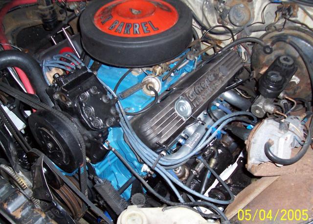

While collecting parts for this project, I came across a '78 Cordoba. And since it was to be modified some, and the Cordoba had a P code 400 that comes with the 727 and a 9-1/4 w/3.21 sure grip equiped rear that is all a bolt in ........... Hummmmmmmmmmmmmm................
Yep, the 318 made way for the 400. It's on!

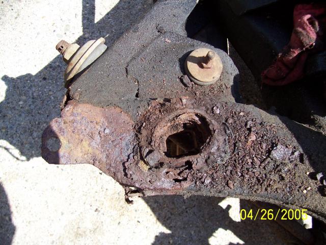

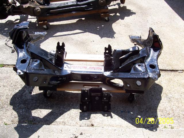

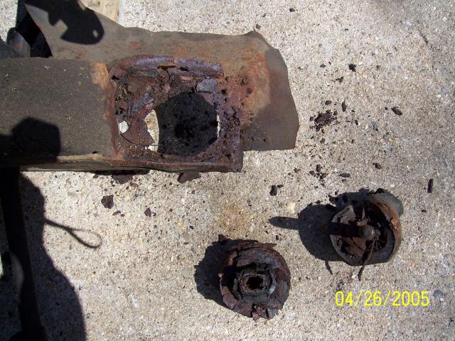

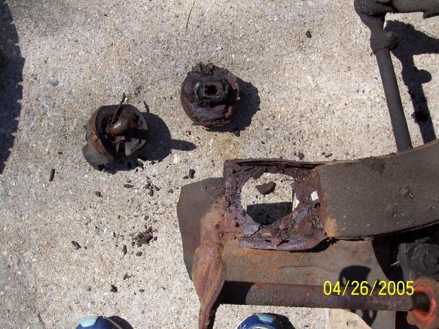

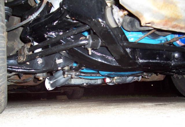

The only differenceis that I grabed another K-frame and used a swap kit to install the big block. The old K-frame looked like this;
Now that I have a mig welder, I can save these things if need be. It really isn't hard to do. Makeing it look good when your done is hard when you don't weld often. Since I didn't have a welder at the time, but enuff money to get a K-frame else where, a dude by the screen name Carbide6 from the style took the time and sent me a 99.5% rust free K-frame and I sent it out for a blasting and epoxy coating.
(Next time I do it myself!)

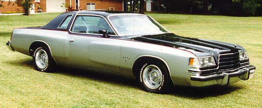

Same showroom floor paint sceme again. I really like the stripe and hood treatment. The only other color option is a two tone black and silver. That is an eye popping combo.
Look below.

That black and silver scheme is OUTRAGEOUS.........Now I'm stinkin' jealous..............

See, I told ya it looked killer. Eye popping and for surely a catcher like fly paper. IMO that is. The "GT" models have fender flares. Extremely hard to find. Last set I seen was old used crack but in very good shape that was priced at $500.
I do believe the car above has the GT wheels.
