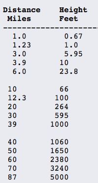

You're probably right. My provider has a tower up on the mountain probably 4000' above the valley so we're likely to get maximum distance but it's definitely not the norm.
Yup, tower at 4000 ft is huge!! 75 + miles!!
Guess i can move even further out in the boondocks!
Well, line of sight should be fine... Now it becomes a matter of signal strength... Plus if there's a 4000' mountain there's probably other terrain... You want to keep that out of your line sight.... If your up high great, as long as your not high on the back side of a mountain/foothill/ridge...
Other than that have fun in the boonies...
