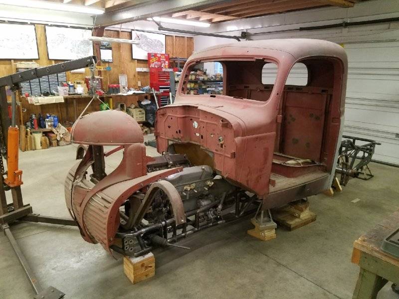

I use Por-15. Never had a
problem after using as
directed with any rust
problems. This on a truck
that is over 80 years old.
Applied after media
blasting, and the cab sat
outside in the weather after
application for a couple
years. It's tough stuff.
