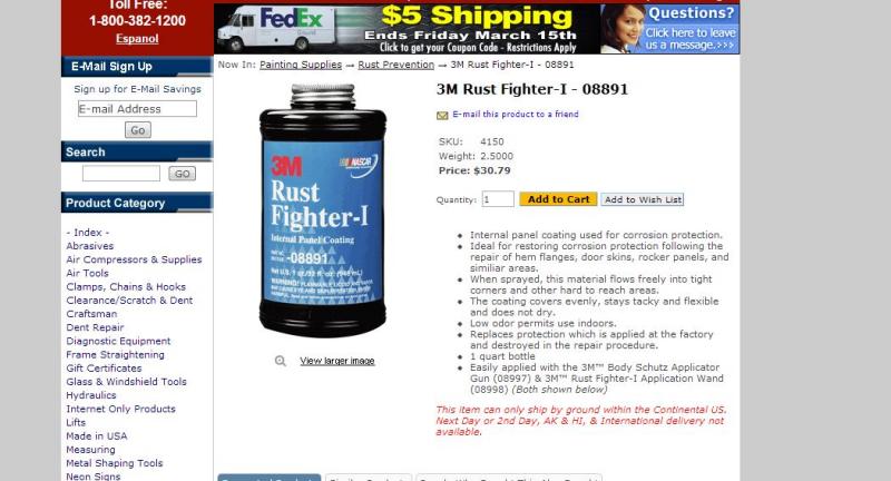

If you're not looking to actually paint anything but just apply a rust preventative measure, I would recommend 3M's Rust Fighter. You can buy in in a quart, spray with a schutz gun and plastic wand or you can buy it in a can...Stuff sprays in like a petroleum jelly, sinks into all the seams and hardens up a bit, but never completely. It can be wiped off after spraying for a bit. Use it on all my cars in the nooks and crannies, especially areas prone for rust. Good luck.
