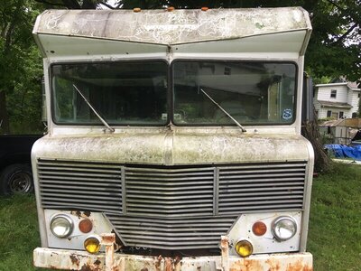

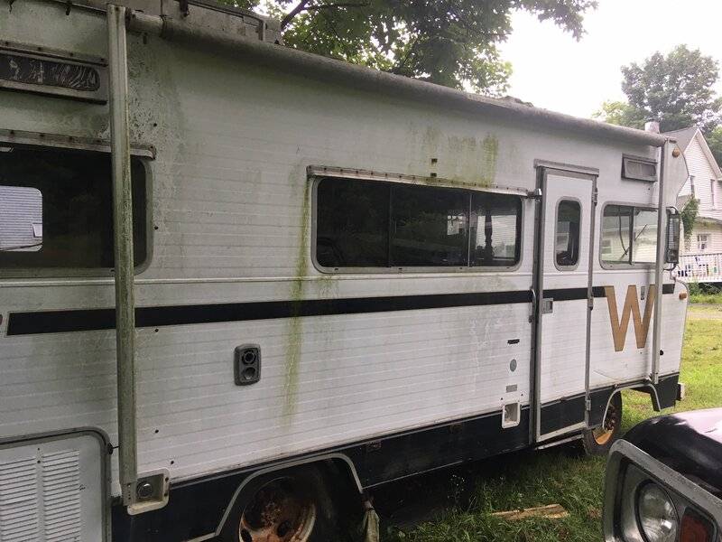

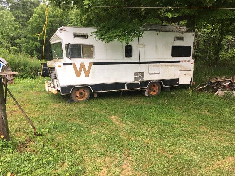

Well today I spent 4 & 1/2 hrs Pulling the 1973 Winnebago 20ft brave, out,
And loading it on a trailer to get it to my house.
It was just 12 foot tall, 13 foot 6 is legal limit her in NY.
The guy I got it from was the 2nd owner, and used it to tow his race car, it has tons of new parts, and when he parked it he even took metal mesh and covered the duel air cleaners snorkles and the duel exhaust pipes.
The inside the roof leaked and some animal crapped all over, so tomorrow I will be cleaning it.
I will post photos when it isnt so badly coved with turds.

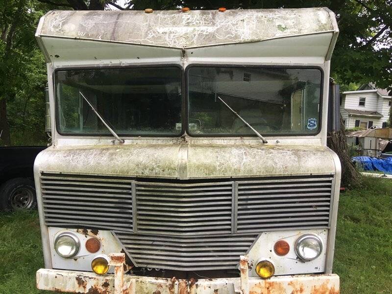

I just noticed if you look close on photo of Winnebago that is of the front, you can see the crap, on the dashboard.
I mean actual crap, freaking gross. I have no desire to rebuild the winnie, I just didnt want to have to work around the petrified poop.
