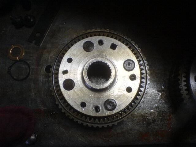

In the case of the front planetary, the weak point is the splines, not the pinion count. 99% of the time the splines will strip out long before a pinion failure.
