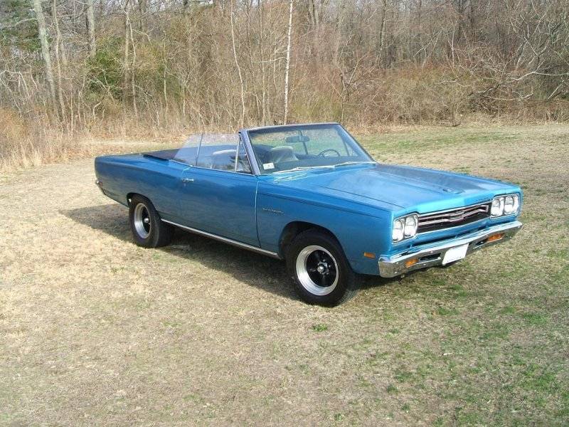

I was driving into work yesterday in my 69 Sport Satellite convert and it just died on the highway. I pulled over, tried to start it and it did not sound right. The starter was not turning the motor over smoothly. It was hacking and weezing. With no tools, I just had AAA flatbed it home. I'm still tinkering but I think it jumped timing. If that's the case then I am pulling it and give it a full rebuild. It's the stock 318 2 barrel. I've had the car for 20 faithful years and it doesn't look like it's ever been out of the car. That's a pretty good run. With the other cars I am currently into, this one will have to go on the back burner for a while. So I will probably be asking for advice here and there in the future. Now the wife can't keep bugging me to drive it.

If it's a factory unmolested 318 you probably shucked the cam gear teeth since these were nylon. Had the same thing happen to my 73 Charger coming home from work, it just died. Since all that junk went to the bottom of the pan and the car had over 100000 miles on it I opted out for a rebuilt X-head 340 out of a 71 challenger. swapped it out in a weekend. Only regret was I should have changed out the TQ converter to a higher stall speed when I had the chance since that 340 likes RPM.
If it runs good (or did) I would be tempted to throw in a double roller and cruise on! Good point from BigBadDad below. Pull the pan and clean the debris out.

What he said above. The plastic timing gear debris need to be cleaned out of the oil pan and pickup. I speak from experience. Lost a 440 once due to plastic timing crumbs getting into the oil pump.

take a look, possibly replace the timing chain and run it like nothing ever happened........ anything in the pan will likely stay there
plug a air hose into each plug hole to see if it holds compression

Don't freak out. See if it's not that bad....timing chain or ignition maybe, or even a fuel pump. But, you might consider what you'd like for your next engine. You can probably find a 318 used engine to keep you driving this summer
A timing chain is a pretty cheap easy fix... If you put the car on the back burner & it will deteriorate... Keep it on the road & keep the wife happy...
Lots of timing chains have been replaced without pulling the pan, is it the best way? No... But it usually works fine..

Do a compression test and you will know real quick if it jumped time or not.
what ignition?
what carburetor?
