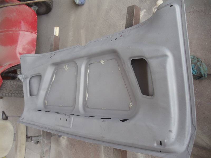

My guy uses free desert sand he scoops up out of the arroyos around here, seems to work (except on undercoating). I did not notice any "warpage" on the body parts, but maybe I did not look close enough yet. The sand seems pretty fine and powdery.
